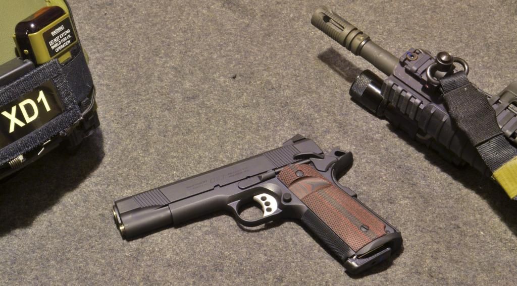

    This came back today from SACS.

    You sent a Colt to SACS? HaHaHa

    Pistol looks great, they did a fantastic job. Which MW is that pictured ? List the options if you do not mind.

    Looks like an S&A with the bevel option.
    A build list would be appreciated. I too have sent a Colt to SACS.
    Quote Originally Posted by RMA View Post

    The MW has a ridge right where the MW & MSH meet so it appears to me it is not a SA (SA MSH sits flush to the MW). Resembles a Baer or WC to me.

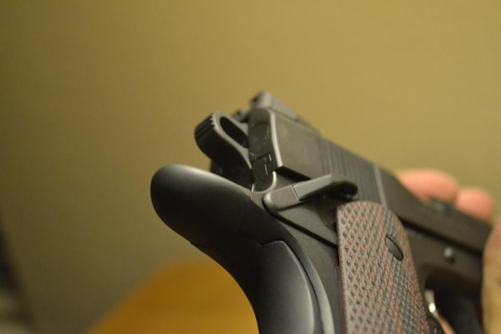

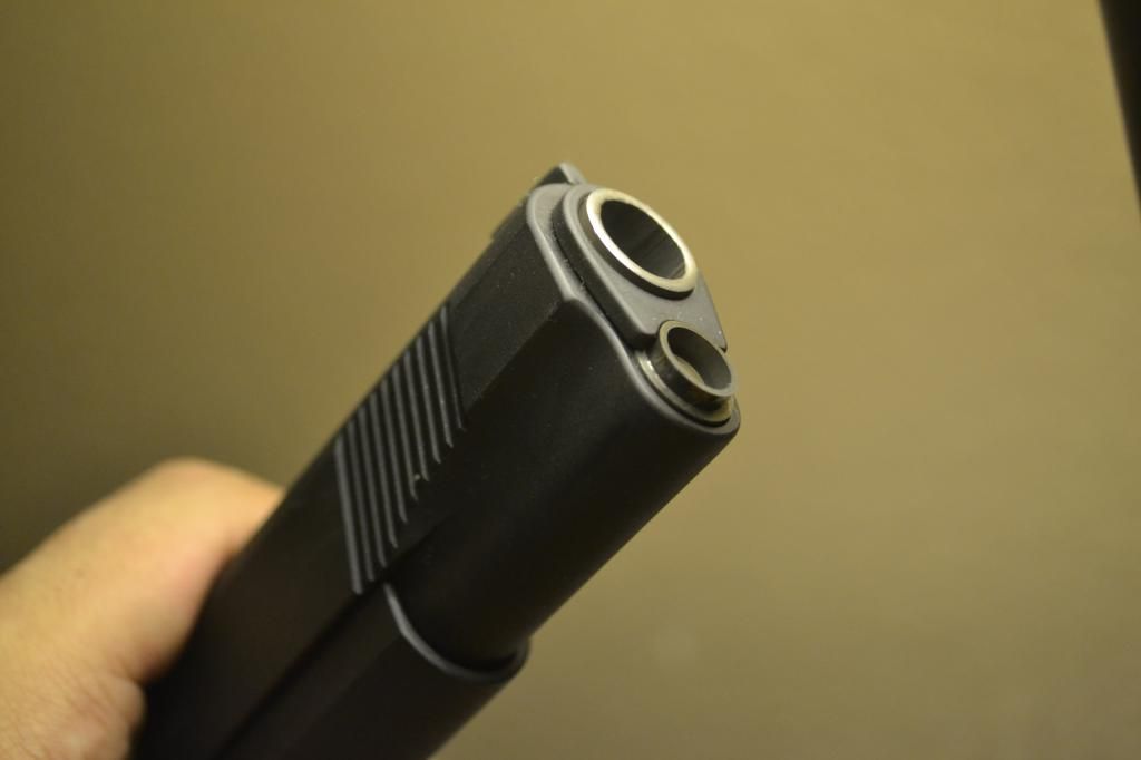

    When she first came into my life she was a used XSE that was a little worse for wear on the outside, but an excellent shooter out of the box.
    So, I sent her in, with parts I'd collected from Brownell's, Midway and Dawson:
    - Ed Brown Slide Stop, Ambi Thumb Safety, Grip Safety and ext'd mag release
    - S&A Magwell (they did the contour)
    - 10-8 grips
    - Harrison Design Plunger Tube
    Over there, they also fitted
    - New Firing Pin Stop
    - Novak Tritium Front Sight (they blacked out the original Novak Rear for me)
    - Complete reliability package
    - 25 LPI frontstrap checkering (this is what pushed an otherwise 2 months job into 13 months)
    - Mild Carry Bevel
    - Parkerized entire pistol
    Detail Pics:
    Fighting guns should be boring and predictable.
    Training to use them in a fight should not.

    I think I see what you are saying. It appears it is not a one piece mw/msh. My mistake.

    Now I'm confused.
    Quote Originally Posted by BUOPtimus Prime View Post

    It is a one-piece.
    I just took inspiration off the contour job I'd seen on guns that Vickers has built. SACS was kind enough to oblige me a similar contour.
