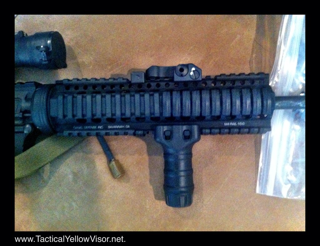

    How mine is setup. Yeah, I can pop that short ladder off in front of the front sight on top and add an X300 if I want to, but on this gun I rarely need to. The front sight is set back more because of where my hand falls and where my thumb sits.
    If it looks dumb but works, it's not dumb.
