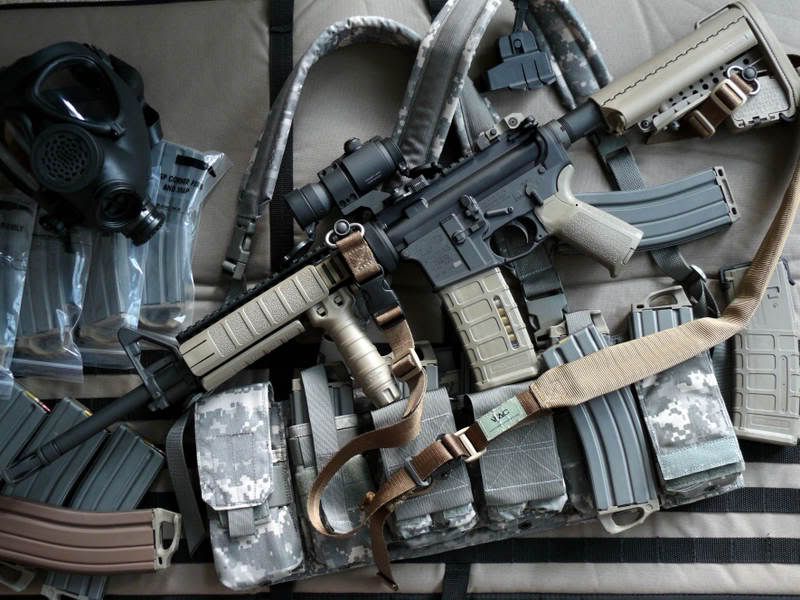

    Blue Force Gear Vickers VCAS two point sling on KAC rail QR sling mount on KAC M4 RAS rail and KAC heavy duty push button QR sling swivels on my M4 type carbine with Magpul CTR stock
    I agree the BFG Vickers VCAS two point sling are great for carbines and could quickly be adjusted, I prefer it on my lighter weight carbine.
    LaRue-Viking Tactics sling with padding which I like better on my heavy weight carbine mounted on Daniel Defense rail QR mount and Vltor EMOD buttstock
    I like the LaRue padded two point sling for my heavier carbine but I'm waiting for the BFG Vickers padded sling to be released because I prefer the thicker webbing material of Blue Force Gear.
    YMMV

    AR-15A3, thanks for the pics. The top picture looks like what my rifle will look like when it's done. It's my first build. Right I have a DPMS lower with a BM LPK, LMT upper, RAS rails, Tapco stock. I still need to get an LMT BCG and charging handle. I'm going to change the stock to Magpul and get a two point sling that will attach to the rail and the stock, and eventually an EO tech.
    Sure, that's an older picture of my LMT carbine setup, currently I removed the Fastex buckle from my BFG Vickers sling, also I'm using black TangoDown rail panels like on my tan carbine and I'm still waiting for shipment of my new latest Troy BUIS which I'll replace my old KAC 300m BUIS.
    My Vickers front sling is mounted on the rear end of the rail and it's setup to be muzzle down on my left side (I'm right handed) when I transition to my sidearm.
    You could mount the front of the sling at the front of the rail if you want it to be more horizontal, I would also recommend the Daniel Defense rail QR sling mount adapter because it doesn't completely rotate and it doesn't make the sling twisted, that's one of my next planned upgrade.
    I would also recommend the LMT M16 BCG, BCM (Bravo Company) extra strength bolt extractor spring upgrade kit and LMT or any other good brand H (heavy) buffer.
    All those parts and accessories are available from Grant of G&R Tactical, he's a great guy to deal with.
    Good luck on your build project.
