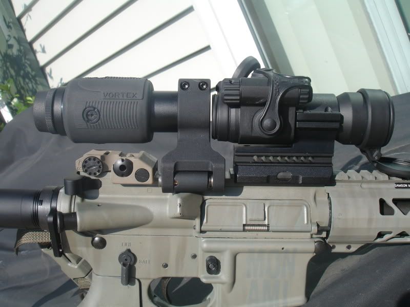

    I'm sure you already know this, piesandcheese, but if the Mako 7x magnifier has a bell on the objective end, you will need to use a mount that has a 2-piece ring; i.e. the LaRue LT755 fts mount won't work.
    However, for reference, I threw my Vortex magnifier mounted in a LaRue LT755 behind my PRO, and it will work. The centerline height of the LT755 above the top of the receiver is 1.725", which is slightly taller than the PRO's centerline in the QRP2 mount. ADM's lower 1/3 swing off magnifier mount may provide a better alignment with the PRO + QRP2, as it should be slightly shorter at around 1.69" centerline height. Bottom line, most mounts that have a 2-piece ring and provides a lower 1/3 cowitness should work fine with the PRO in the QRP2 mount.
    Height example pic - LaRue LT755 -
    Pretty close fit with PRO entirely on the upper receiver, but it works:
    Move the PRO forward one spot so as to overlap the HG slightly, and the fit is more comfortable:
    (Edit: Rifle is unloaded and hammer is down/released,hence selector on FIRE.)
    The magnifier is mounted as far back as it will go. Other mounts may have a smaller footprint, thus allowing more flexibility as far as where it goes.
    If you don't need a flip mount, look into any QD 30mm ring with a 2-piece ring.

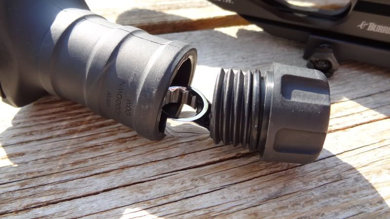

    Extra-bonus content - If you can live without flip and QD, get a nutted mount and a cheap 1/2" combo wrench - cut off the box end of the combo wrench short enough to store it in a pistol grip or VFG (A chunk of Kleenex, lens cloth, or other material keeps wrench from rattling around). Not exactly QD, but a small enough tool to stow on the rifle or keep in you pocket when using the magnifier.
