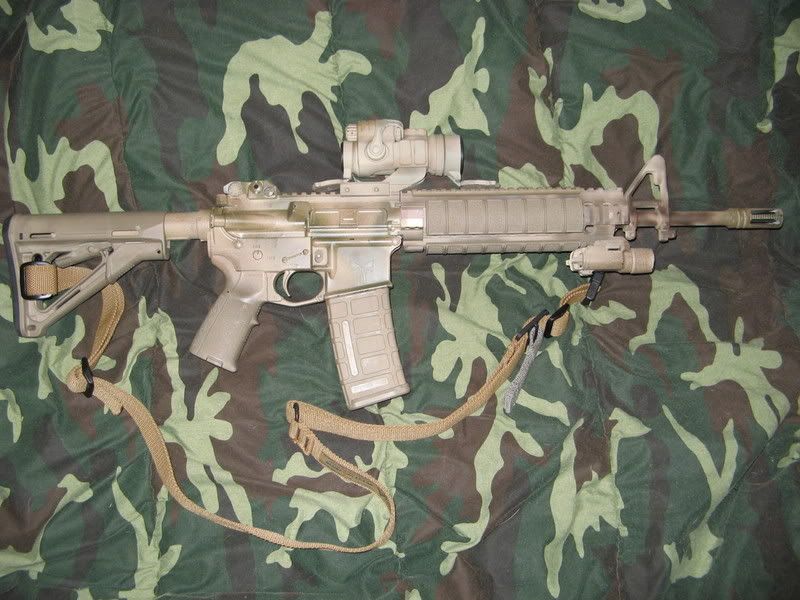

    I have used Alumahyde II and Krylon, and have seen a number of others in person. There isnt a finish out there that is "forever" and wont chip, scratch, etc. That all said, I still prefer Krylon for do it yourself jobs. Its easier to work with than Alumahyde II is, and easy to touch up if need be. I have had some krylon'ed guns that have seen a lot of training use, and in an out of the truck every day, and other than wear spots on high points, they still look fine.
    Right at 3 years on this one..
    Just over a year on this one..
    Wear marks are mainly around the magwell, etc..
