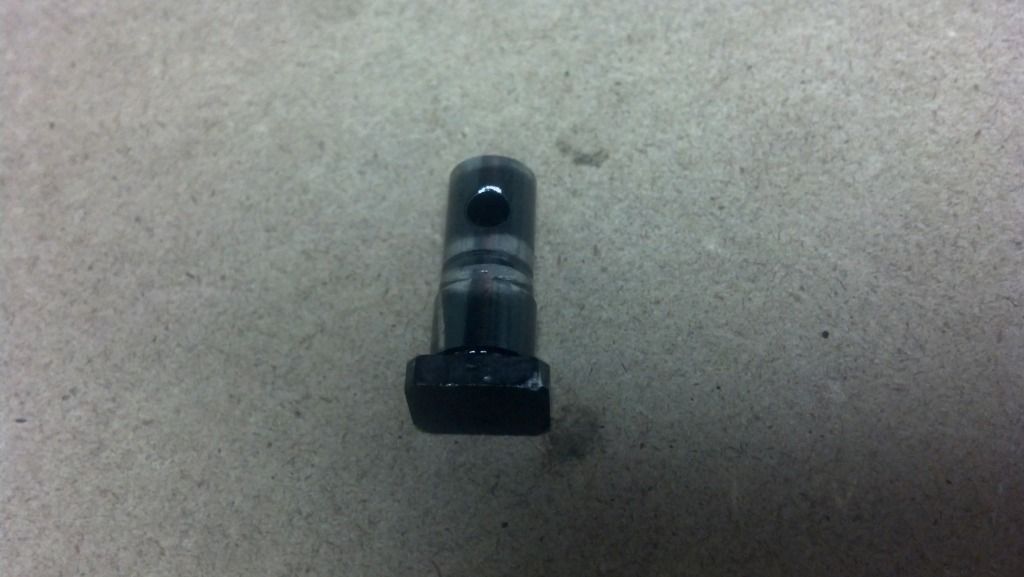

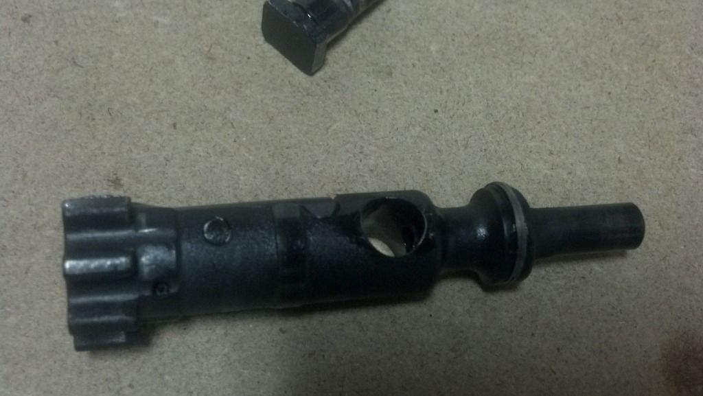

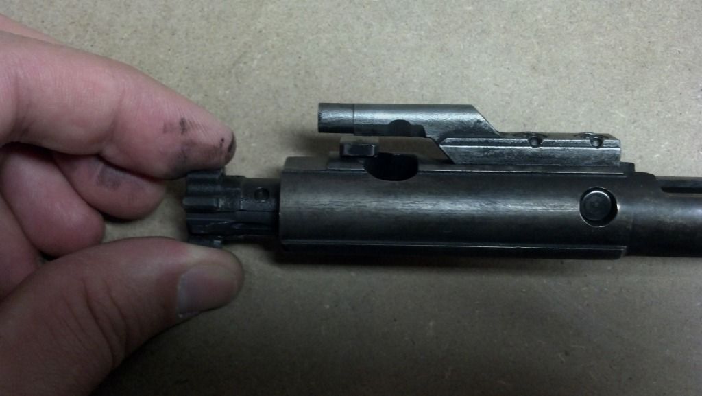

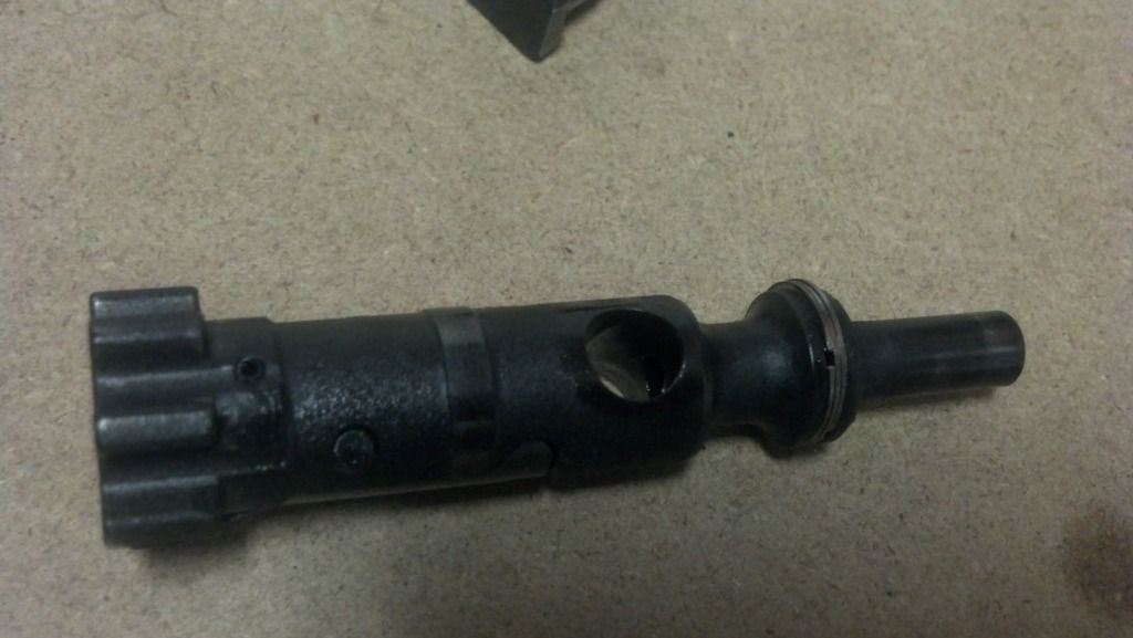

    Well as a few have mentioned, I screwed up the orientation of the bolt when I swapped the extractors. I HAD NO IDEA THIS WAS EVEN POSSIBLE. Obviously, this was my fault; however, I think I may have uncovered yet another issue with either the bolt or the cam pin. Based on my conversation with others....this is not supposed to be possible. The cam pin can definitely be inserted into the bolt as is evidenced by the pics below. Before anyone asks...no I didn't use a hammer, punch or any other tool to get the cam pin into the bolt....just by hands. Of course, I am going to test the new extractor, but something else is out of spec. I'm sure KAC has 10,000 bolts laying around...surely this is something they would warranty. Let me know what you think guys.

    Dude that is way weird. It should not be possible - however an infinity number of monkey on an infinite number of typewriters etc.
    Email Tom and I, and I will get him to give you an RMA, as I want to look at it.
    Who's Bolt Carrier is that? There is a cutout on the Gas Key I have never seen before.

    Its a Fail Zero carrier.
