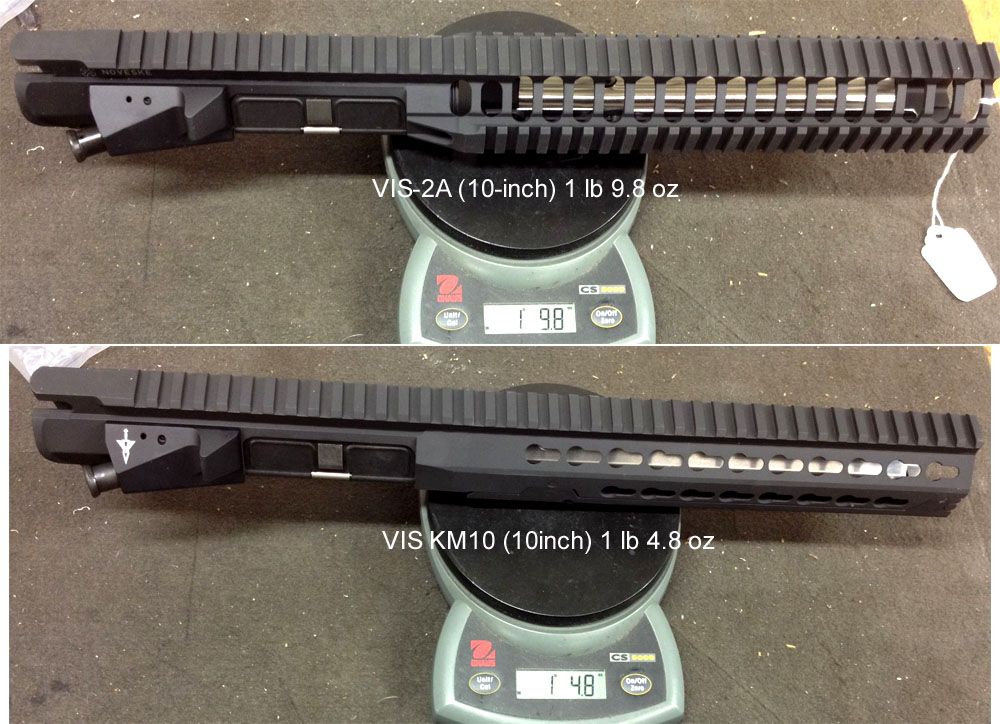

    With this official introduction, I’m releasing the prints (shown below) to the firearm industry, so fellow companies can develop their own rail systems/platforms utilizing the KeyMod configuration. I added a sample component print (4-inch rail section) showing the mating interface to the outside of the platform surface. I also included a picture of the accessory nut that interfaces/ indexes to the chamfered surface on the backside of the platform. Please note the nut has a counter bore, so the mating screw can be distorted at the tip. The thread distortion will stop the screw from backing out, making the accessory a self contained, self centering, “drop and slide” mounting component. As you can imagine, there are a number of companies that are already developing and/or manufacturing components that mount directly to the slots. For example, Noveske and I are making our own rail panels, to work with “our” platform requirements. Other items being developed are VFGs, handstops, bipods, light, sight and sling mounts. The possibilities are endless.

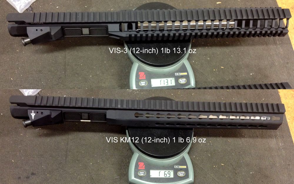

    Weight savings compared to existing VIS (KM prototypes shown):
    Additional images of lower handguard:
    Vltor will be offering the same four lengths as before (7, 9, 10 and 12-inch). Each VIS KM version averages a 6 ounce weight reduction over the original VIS system. Relevant to suppressor users, the internal dimension of the VIS KM is 1.400" (without the heat shield) and 1.125" with heat shield. The outside diameter is 1.725 inches. The total height (from the top of the Picatinny Rail to the bottom handguard) is 2.125".

    So it seems that the weigh savings of the VIS-KM over the standard VIS will be somewhere between 4-6 oz. depending on the model.
    I'm guessing that the 9" VIS-KM will save about 4.5 oz, correct?
    This may be an ignorant question, but will 4.5 oz be extremely noticeable if I were to switch my standard VIS over to the KM?

    Yes. It depends on how you look at it I guess. If you are doing a hundred presentations a day or one hundred target transitions with your rifle one ounce can really add up after awhile even if you do not notice it on the first few movements up or side to side. It will make a difference for me.
