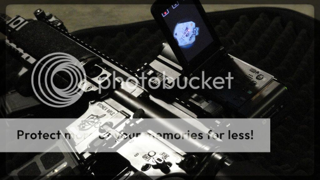

    You nailed it with the rubber pad b/t mount a camera bottom. All my various redneck'd mounts have had this feature which makes audio perfectly clear.
    Recent mount...used a thicker, yet softer foam padding rather than hard rubber like I used in the past.
    Older mount of mine with a thin hard rubber pad...

    Your mount looks very sound OP, and seems to be well thought out.
    A behind the optic camera mount is my "Eleanor" however. Maybe next up you should try to tackle a mount like that. I know lots, and lots of people who would pay for that type of camera mount.
    Smart man...especially since you didn't have to find this out like myself through trial and error.
