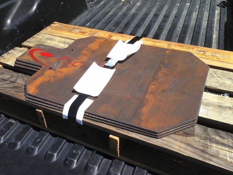

    That's why God made 1/4" armorgard.
    Even the 77 gr SMK will wiggle these a little at 1000.
    I'm glad you have control over what targets are used at all the matches you attend.
    I don't have that luxury.
