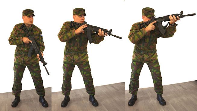

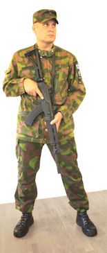

    I'll chime in as I am pretty much 2-point school of thought.
    FDF uses AK's with two point slings. Rifle is carried hanging from the neck 95% of the time. That means that sling doesn't go around your shoulders on either side. In transition the rifle would be left hanging unsupported or it could be held with the support hand. If two hands are needed (searching a suspect, carrying other stuff, etc.) firing hand would be just put through between the sling & rifle putting the rifle hanging on your back muzzle down, barrel on your firing hand side buttstock on the other shoulder. Very much like you would run an AR American style except for the sling not going around the support shoulder.
    Why I wrote this is it works relatively well. It is fast, comfortable, simple. I wanted to write this first because I think there are good ways to work with the 2-point sling. Now on the other hand:
    I really do not like one bit the method of throwing the rifle over ones head desperately trying to hang the rifle in a hurry. It just doesn't work always.

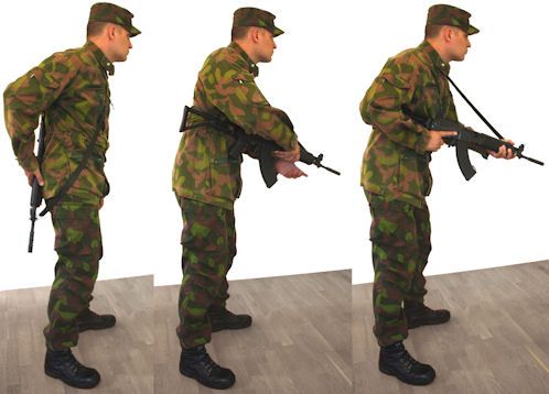

    I added a few photos of the sling usage we do here to clarify the matter.

    I think you end up exactly as in the first picture in this sequence -

    5. It is absolutely too slow to get the gun back in your hands from hanging.
    Its slower to bring the gun back into action when it is behind your back versus in front of your body. Again; economy of motion
