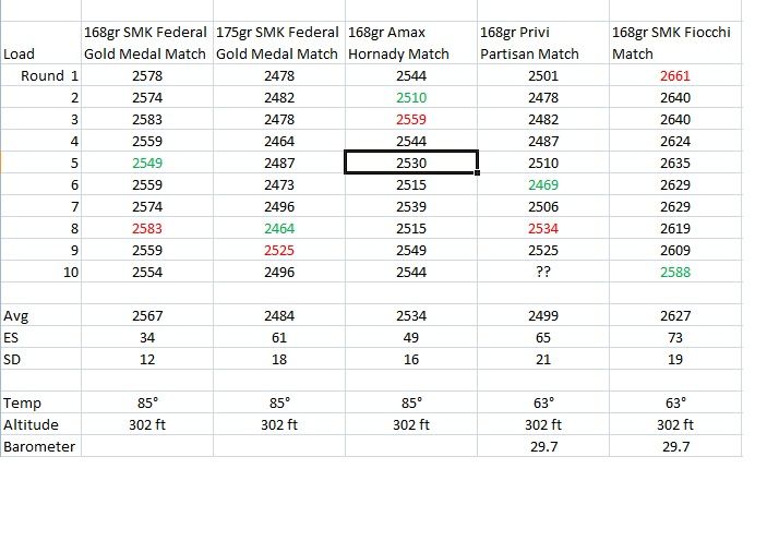

    The data below was collected from my 18" Stainless barreled LMT MWS in 10rnd strings (except for the Privi where there's a round missing?) using a ProChrono Digital approximately 6' from the muzzle.
    I hope it is useful to some.
    5,117
    Given the relatively recent movement towards 16" .308 ARs, any velocity data based on 10 rd strings using popular/abundant factory loads through them will be quite valuable. Thanks for going to the effort of organizing it so well as well.
    My GMM strings mirror yours almost exactly. Same thing with your Amax numbers. (ES/SD wise). As I've stated before, FGMM 168gr. SMK through the 16" CL is really amazing in terms of precision, however outside of the Federal Fusion 165gr. load....it, and the 175gr. SMK variety pack easily the most recoil for any factory load I've shot out of 15-20 different types.
