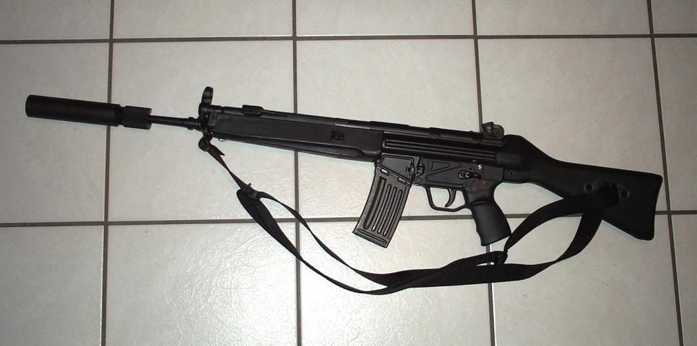

    I know the older model installs on a HK 33/93 and I think that is longer than any A2.
    I know they fit on my A2 HBar.
