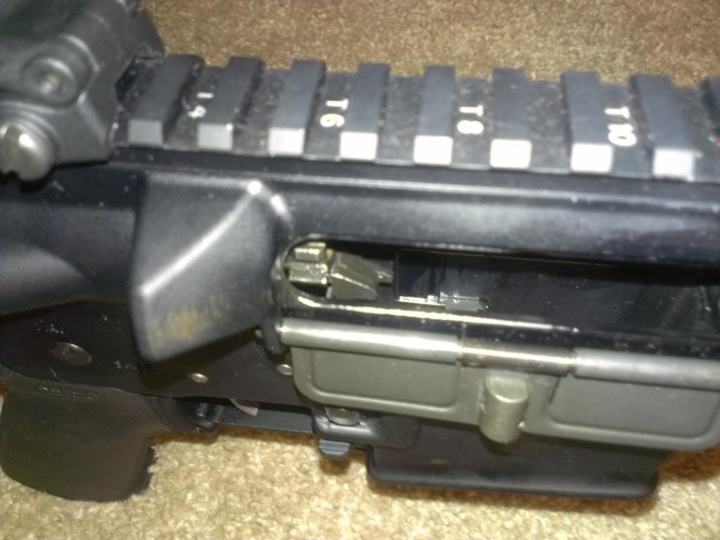

    Pictures are worth 1000 words.
    Now we can get somewhere.
    PIC1
    I'll bet the problem is with the spring.
    It's too short and looks like it has too many coils.

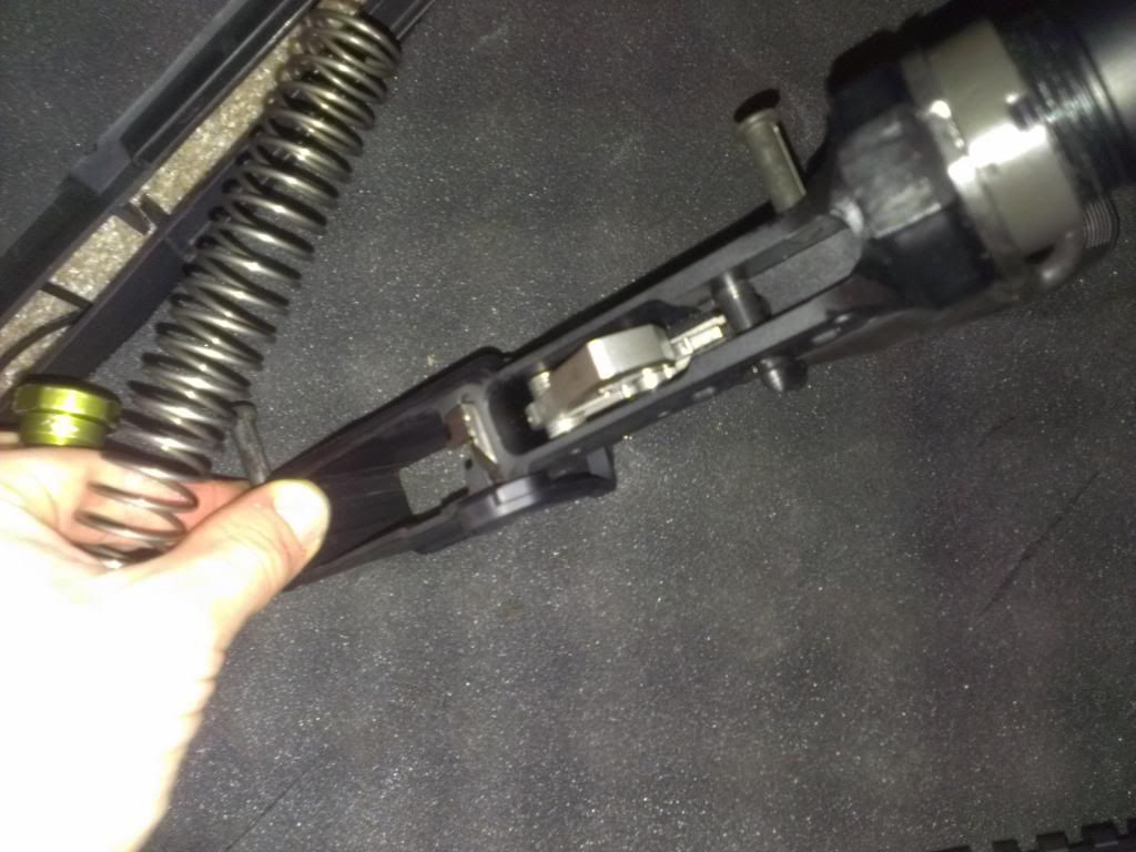

    Quote Originally Posted by chaarp1 View Post
    PIC2
    This is doing it wrong.
    The bolt needs to be in the forward position with the carrier all the way back.

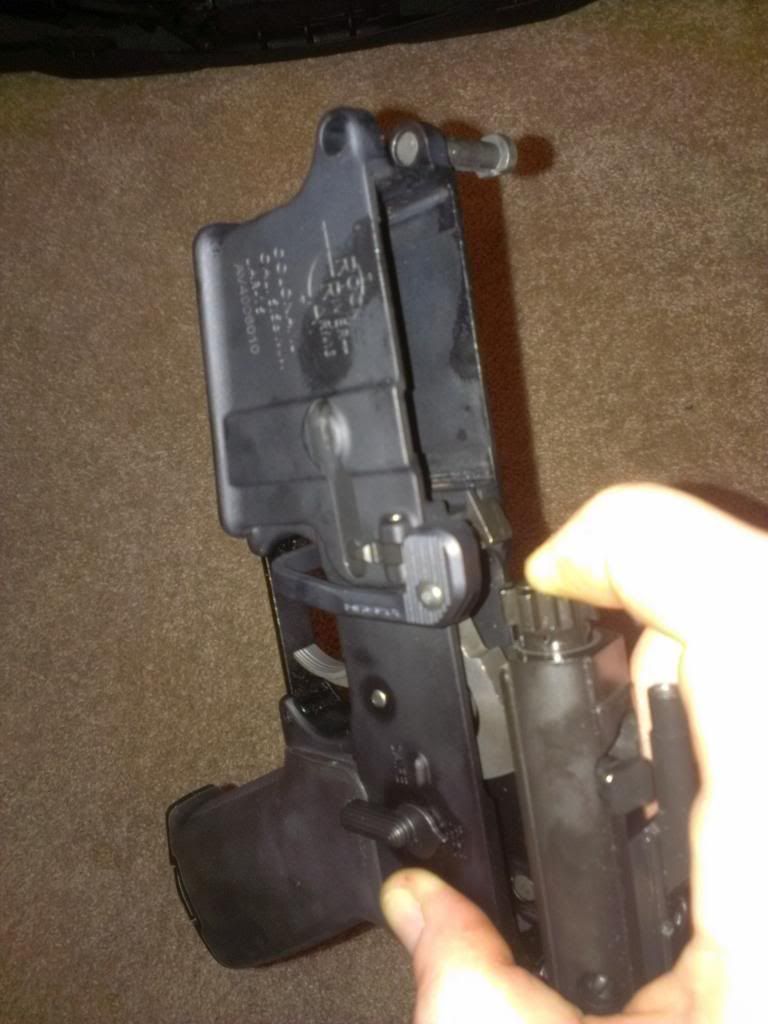

    PIC3
    This shows there is NOT nearly .250" clearance.
    The spring is probably at its stacked height, preventing full travel.
    To verify the spring is the culprit, remove it.
    Put ONLY the buffer into the receiver extension tube.
    Reassemble the upper and pull the charging handle all the way back.
    If you get the .250" clearance, you've found the problem.
    Gently bounce the rifle straight down on the flash hider to return the carrier forward and allow removal of the upper.
