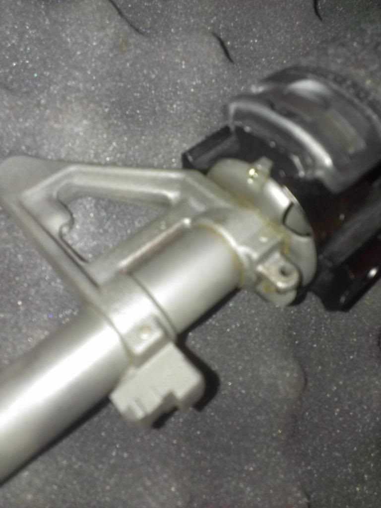

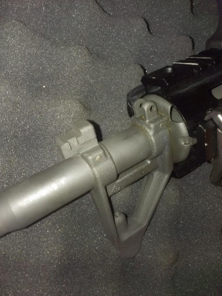

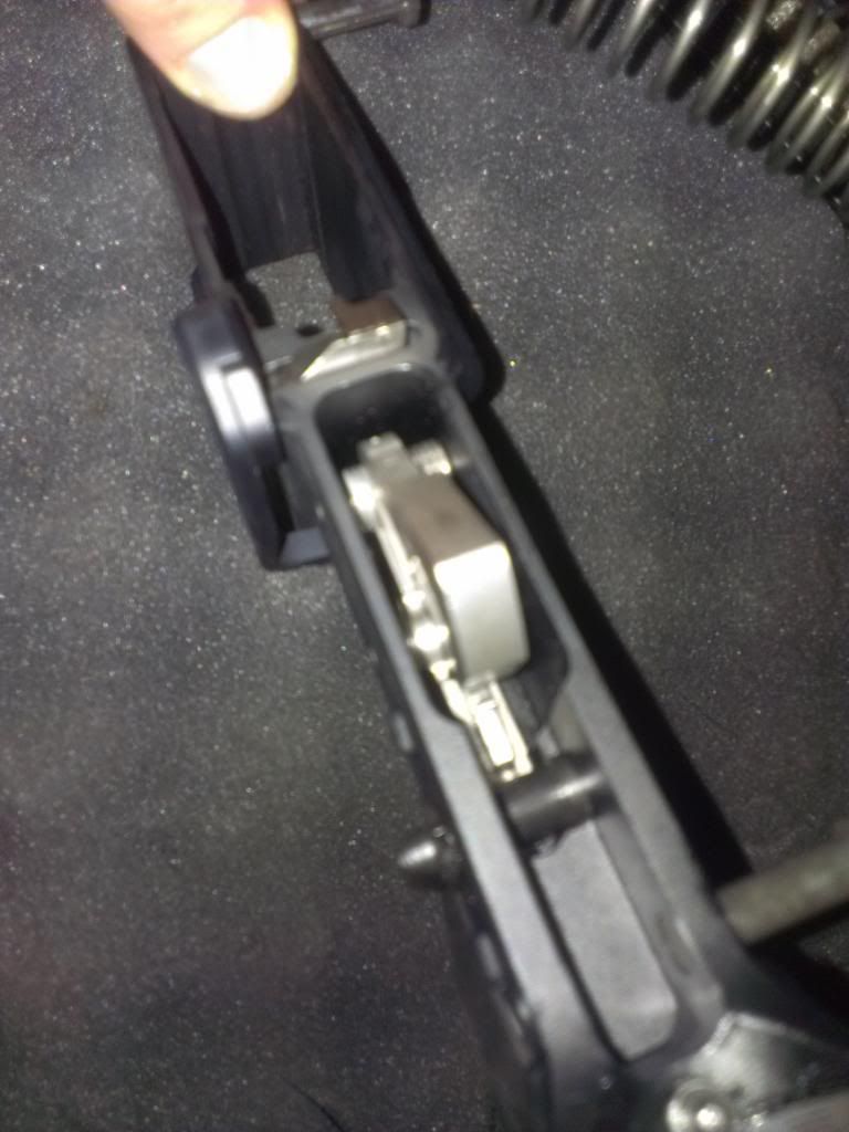

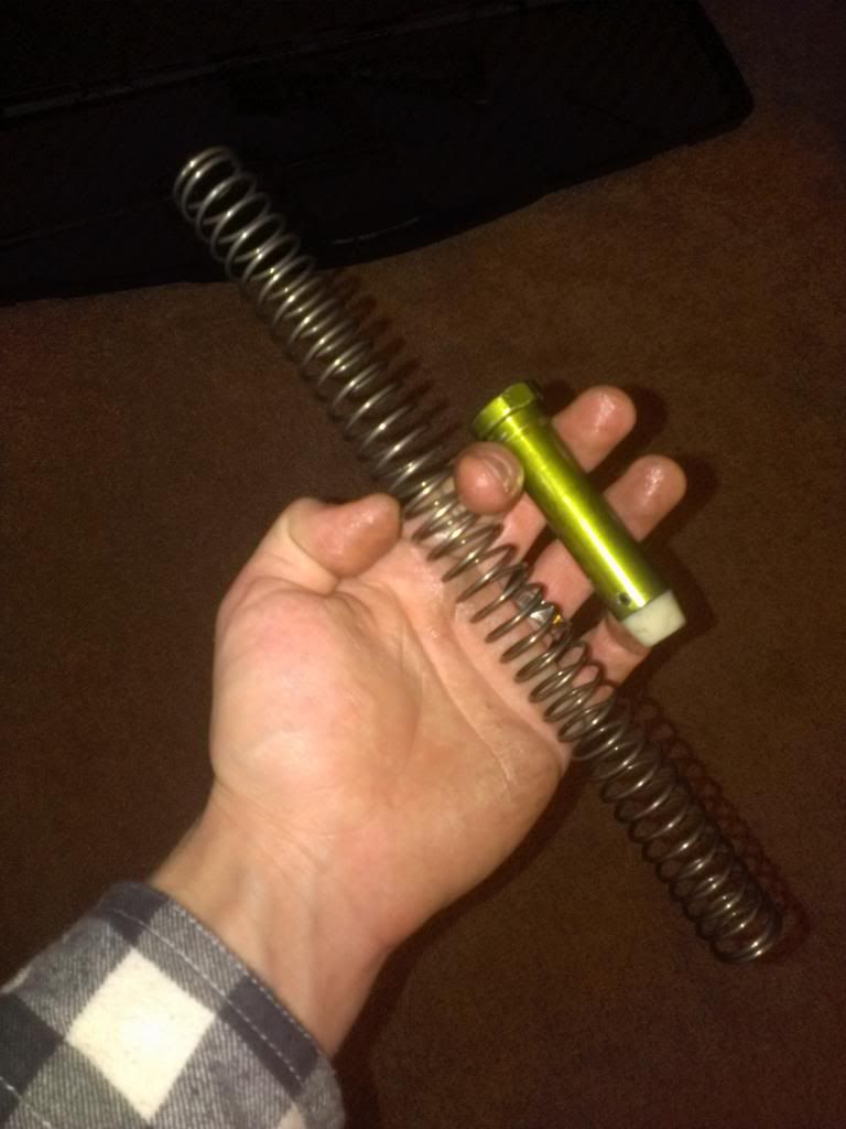

    ok here are some pics gas block w crap that had come out of it(looks like rusty oil).... i checked the key to see if there were any leaks and there are none...the biffer is 3 1/4" the buffer spring is 9" i do NOT know the make of buffer, buffer spring or tube.....
    other then that the lower is rock river
    daniel defense lower parts kit
    stainless steel trigger group
    the upper was complete from M&A...dont know much about them...it is a crome lined 5.56 1:9

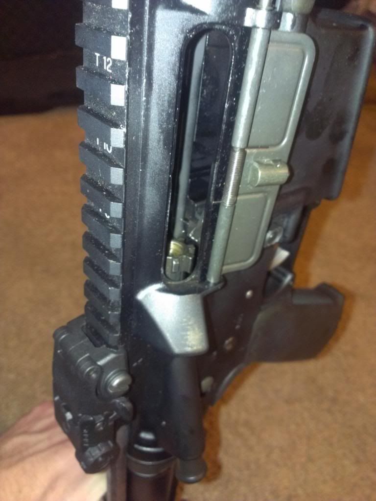

    so the last pic is of me holding the charging handle back and pressing the bolt catch up...there is like .010-.015" clearance ...but thats with the handle not sure if when its running it will retract further ...also its a cheap cheap charging handle i plan on replacing it soon but just spent lots of money on ammo and a few more pmags because of this stupid government trying to take away our 2nd amendment rights
