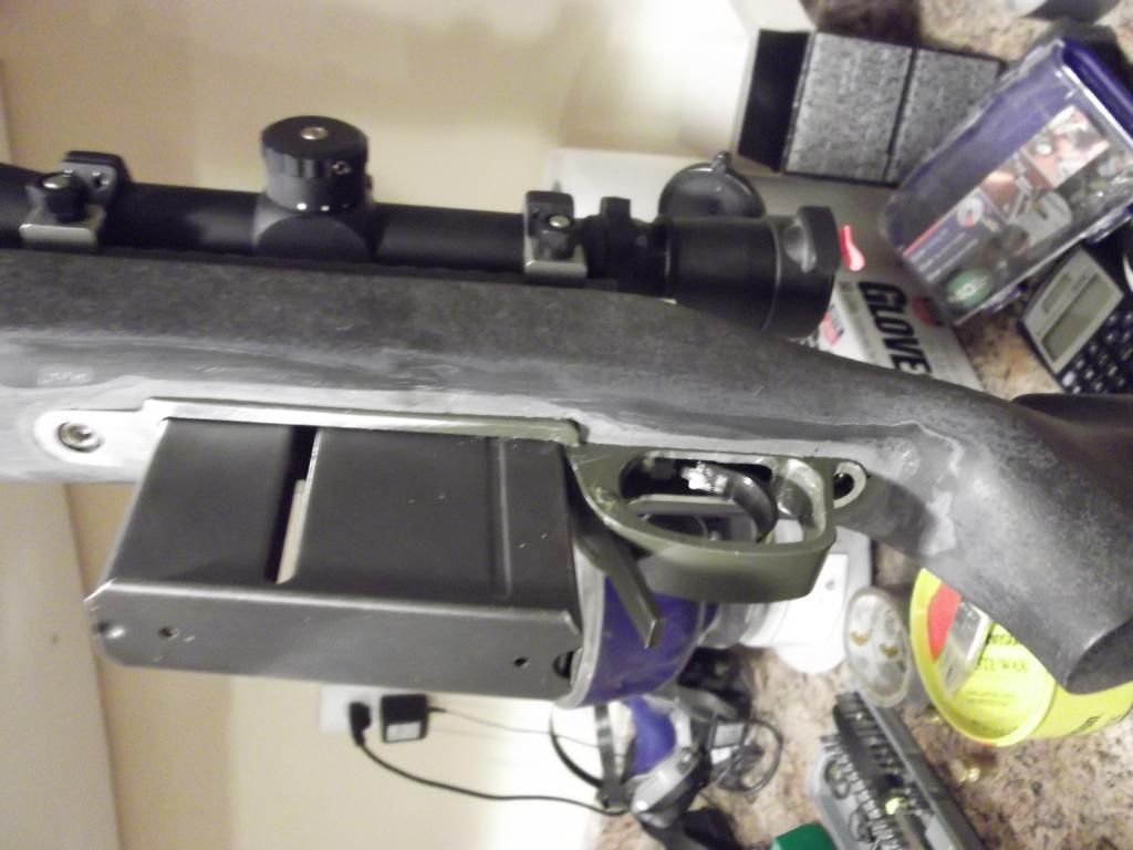

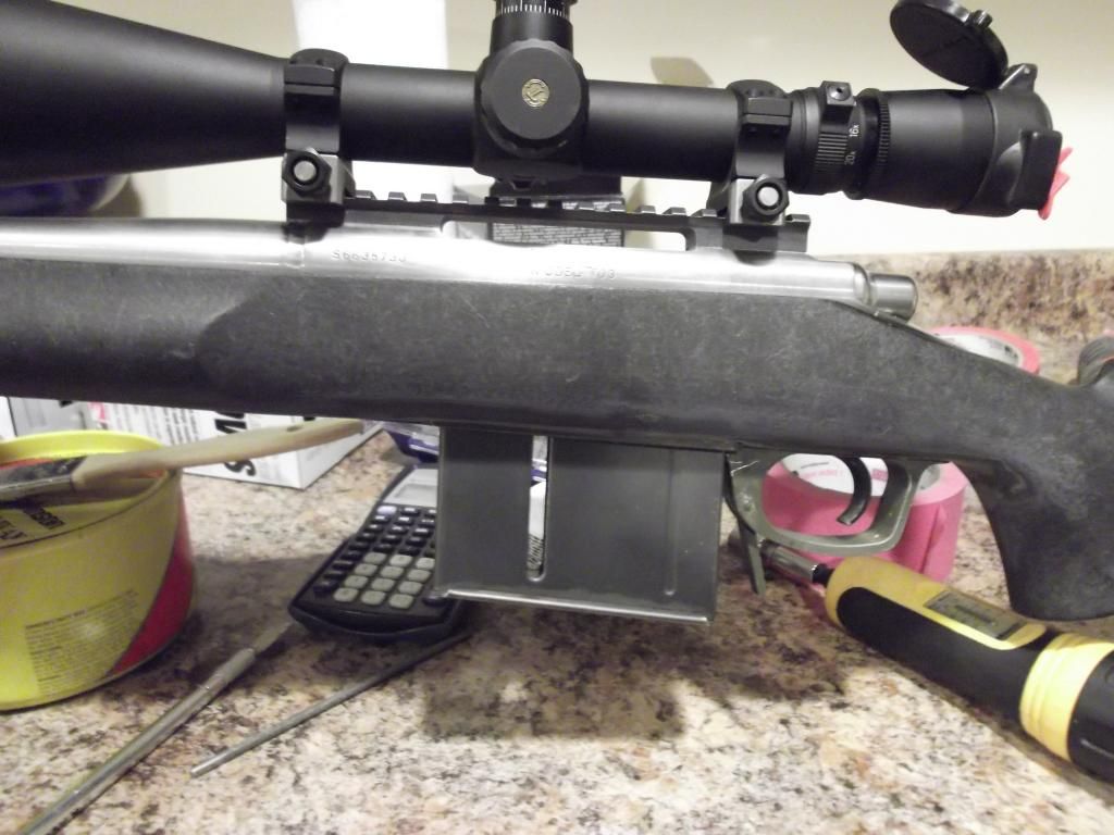

    Well Its been nearly two years in the making. I finally have my 264 win mag ready to shoot. This was a parts build, all the way. Got the barreled action here, stock from Shawn Carlock, Trigger used from a friend, detachable mag system here, and base from ebay. It one of those cases of waiting and waiting for deals.

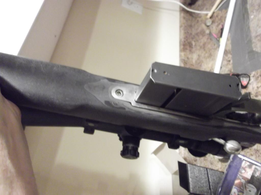

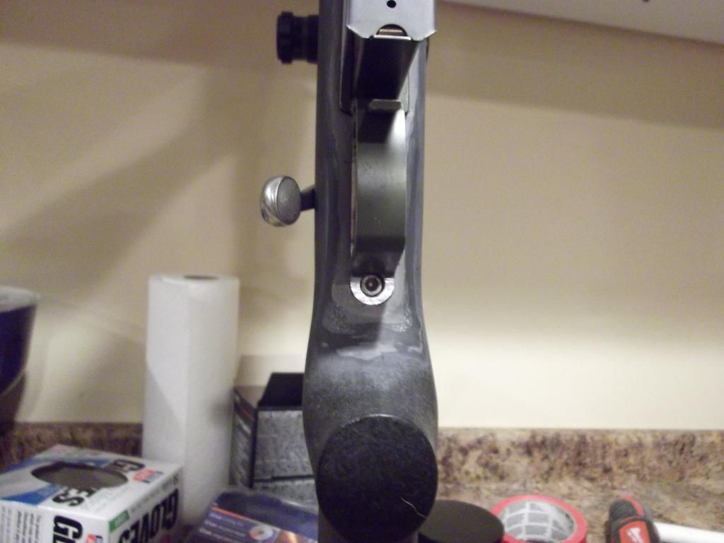

    This is the first rifle I have ever bedded, the first mag system I have installed. Let me tell you OMG this was not easy. I only have hand tools and patience. Its not as easy as I thought.
    Rem Sendero 264 win mag( got a spare 338 rum barrel on shelf)
    Timney trigger
    HS stock from Shawn Carlock with his cheek pad installed
    Atlas worx bottom metal and AI mag
    harris bipod
    Leupold Mk4 M5
    I have not shot it yet, I am going to put some loads together tomorrow with H1000, 140g vld, nosler brass, and CCI BR2 primers. I will let you guys know how it turns out, I'm pretty excited.
    I need suggestions on stock paint colors?

    What you think of that bottom metal? Compare it directly against another brand for me if you could.

    Thanks guys, I have a bunch of Alumihide 2 and some duracoat here I can apply with my airbrush. I have been considering adding fiberglass resin to the pistol grip area, for texture but I like the smooth surface.
    As for the MK4 its my second one and I love it! I have it for sale only for one reason and its to get all my optics on the same page (horus).

    I expect to get 3200+ with H1000 and the 140g VLD. But the rifle will tell me what it likes. I have to get a new powder scale, then I will do my my pressure ladder test at .015 off the lands. When I see pressure I back off one full grain, and do my 24 round seating depth test at that charge weight.
