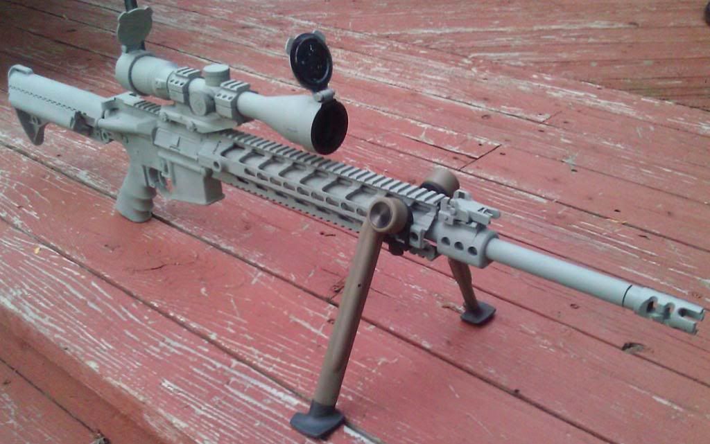

    i just got one a couple weeks ago. satisfied!
    nearly got the MI SS G2, mainly b/c it's 2oz lighter. but in the end, the industrial design and the more open ventilation won me over despite being more expensive than the MI.
    also, depending on how you look at it, the REV's 4 QD sockets and full length lower rail more than offset the cost diff.
    then again, they could probably get back that 2oz without the extras... I'm betting they like the symmetrical look of top and bottom picatinny's more than the weight/machine costs.
    picks, in order:
    max ventilation (replacing solid Al tube that overheated way too quick).
    light weight (went on a 20in bull barrel upper, so it matters)
    great design (as in, looks good)
    reasonable price (esp considering rails, keymod, QD mounts)
    uses std barrel nut (no proprietary wrench, etc.)
    quick and easy installation
    nits, in order:
    doesn't fit Vltor MUR upper receiver (this is MUR problem, not fortis problem)
    wish the bottom rail was like the l/r sides - key mod w/ just a bit of rail at the end.
    so narrow that it feels too tall (but that's good for key mod accessories)
    fixed rails at the end interfere with "magpul grip" (so just a little less configurable than plain tubes)
    wish that it was a true 2 piece FF, but that's just ungrateful of me
    final opinion: recommend and wouldn't hesitate to buy again.
