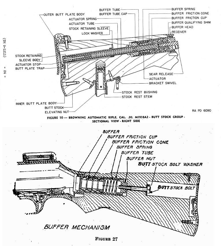

    A good analogy for the firearm action spring and buffer is the spring and bump stop system used on automotive suspensions.
    In the simple case of a leaf spring truck axle, there will be the leaf spring (action spring) and a bump stop (buffer).
    The bump stop is most often a rubber on steel contact point, but can be steel on steel in the case of overload springs like used on a dump truck.
    One other key defining feature is:
    the action spring is active during the full action stroke,
    while the buffer is active only during a short distance at the end of the recoil stroke.
    The AK's bump stop is generally the rear trunion, steel on steel.
    Other firearms use a very heavy spring, or an rubber/urethane bumper as the bump stop.
    The original M1918 BAR has a heavy "buffer spring" surrounding the "actuator spring" (action spring) .
