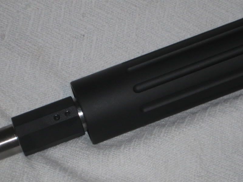

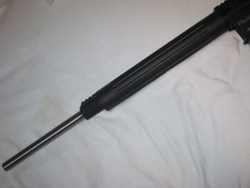

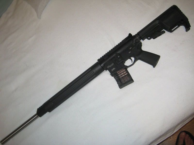

    Hello all,
    I managed to score a 24" stainless bull barrel upper for my precision rifle build. I need help. I really REALLY like the handguard on the rifle. It's free-float, round, and completely
    devoid of any rails or sling mounts - which brings me to my problem. I know that mounting a bipod directly to the barrel is a no-no since I'm building this rifle for pure long-range accuracy - so what do I do? Do I have any viable options other than drill that puppy out and add some kind of mount?
    Also, the gas block rail is mounted lower - for a front BUIS I know that I'm going to need a special gas block sight - anyone have any recommendations on those? I'd like to keep it somewhat low cost but bulletproof. I keep seeing MI pop up but I've never been a fan of their work...
    Thanks is advance!

    Any pictures? Sounds like drilling is going to be your only choice.

    It's really a simple process to drill and tap a hole for a sling stud, or two holes to mount a small rail section. Maybe the guy didn't put on a sling swivel or rail because he planned to shoot it off sand bags exclusively.

    Hmmmm.. the thought of drilling that beautiful handguard isn't appealing but I may have to just bite the bullet.
