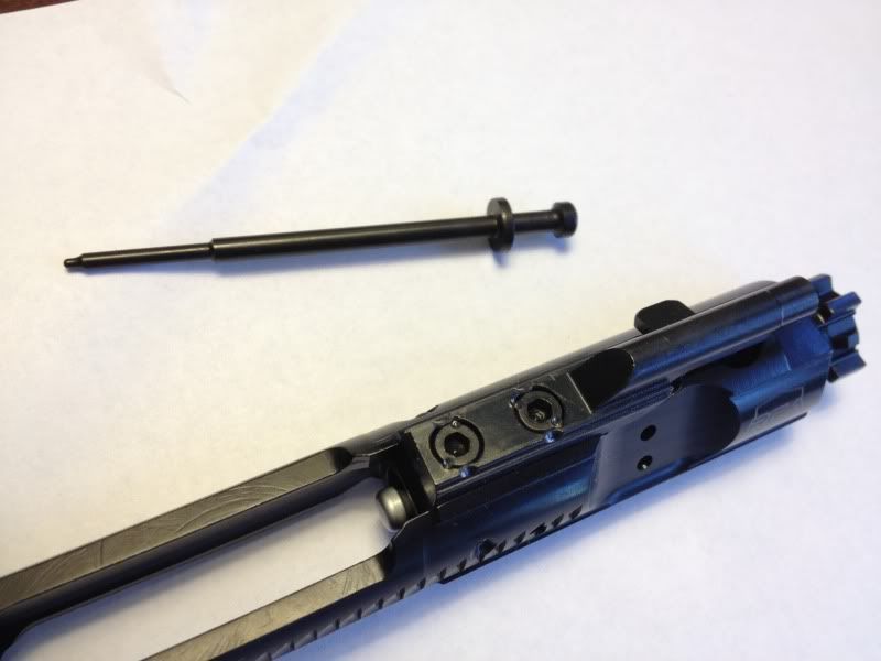

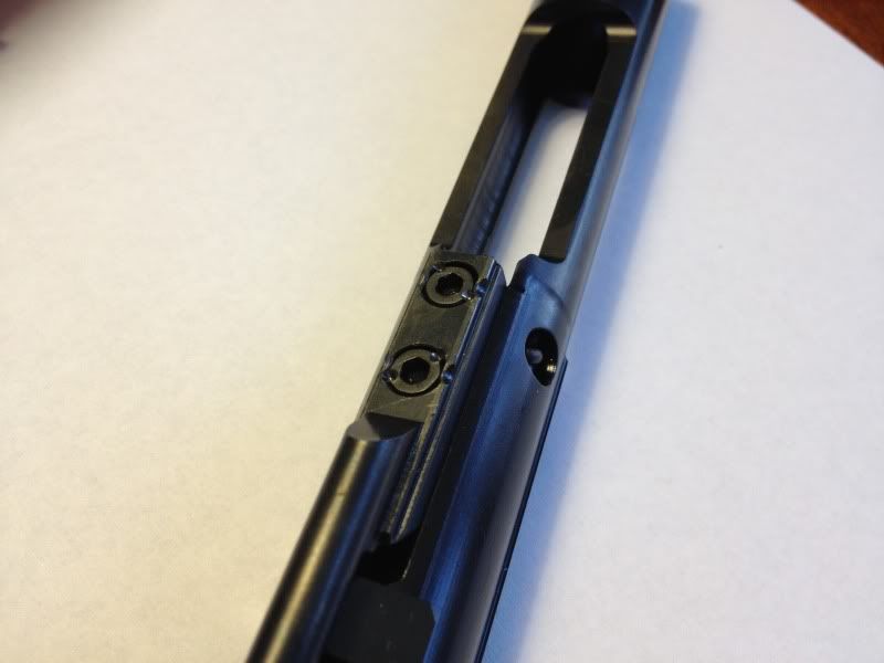

    RCA has their new staking machine. They restated my BCG with it and sent it back with a nitrided firing pin. They would have refunded it no questions asked but I requested they restake it once I found out they got their staking squared away.
    Looks crappy but I know now that the fasteners are not coming loose.
    "When in doubt restake. You can't have TOO MUCH or TOO GOOD of staking on the carrier key, this would be like having TOO MUCH money or TOO MUCH reliability (no such critter)." - Robb Jensen
