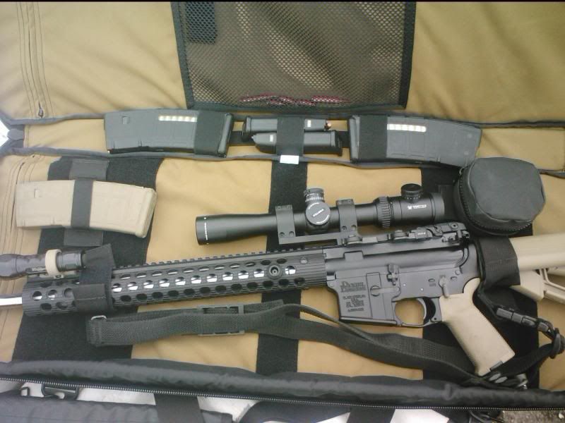

    MRAD
  3. #83
    Jan 2010
    39
    That's a thing of beauty.
