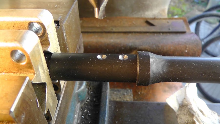

    I had an hour before work today to at least add those dimples to the barrel under the GB. I clamped the workpiece using a pair of aluminum v-blocks and supported the breach end using step blocks. The transfer punch marks are barely visible but enough to find center along the x-axis. I used an edge finder to index off the y-axis.
    Rather than use an 11/64" drill bit, I just used a #5 combination Drill and Countersink cutter. I only needed to drill as deep as the beveled cutting edge. At this point its all eyeball...
    One down, move .450" along the x-axis and repeat...
    Test fit...perfect! I'll add the cross-pin before calling this project complete but at least it's progress
