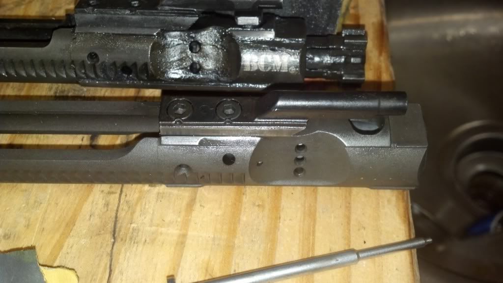

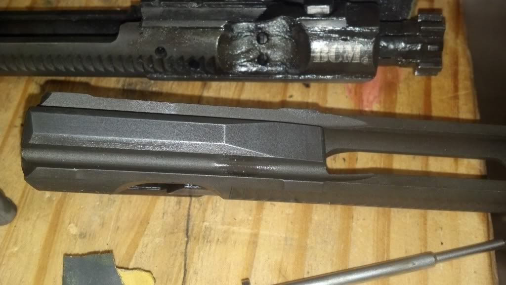

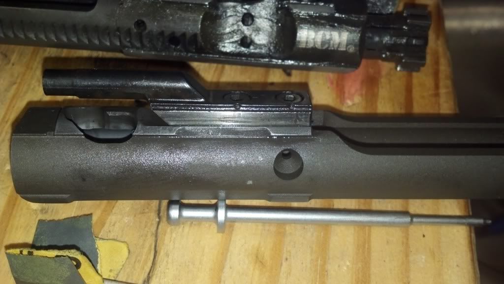

    Quote Originally Posted by BufordTJustice View Post
    I know some have had different levels of success from others here and every gun is a different beast unto itself. However, I CANNOT over-emphasize how important it is to lightly polish all interfacing surfaces on the carrier in order to reduce friction. Some flitz and a rag, or a low-rpm dremel and some jeweler's rouge and VERY light pressure (you just want to polish the "peaks" of the rough metal surface) does WONDERS for friction reduction.
    Way ahead of you brother.
    -Jax
    -Ryan Job

    You highlight the role that friction plays in the system....even absent any grit or fouling and I agree it plays a VERY large part. Larger than most people think.
    Most people overlook the sides of the gas key, the bottom of the carrier, and the tail of the carrier.
    Jax, right on brother!!! Looking good. It should be smooth to your finger and feel almost oily even when dry. There will still be some coloring from the phosphating in the valleys, but the peaks will be shiny and smooth. I've been finding that applying some Aeroshell 7 grease to the rail sections and the the bottom where the hammer rides on the LMT e-carrier with a toothpick (again, VERY little grease) has also smoothed things out a lot as well. Just a very thin film.
    I have said this from the beginning of my original thread: friction is the ENEMY. The only thing I don't like about NiB is the tolerance stack it created when running an NIB bolt and carrier. It made the McFarland gas ring especially tight inside the carrier. I don't think Spike's (maker of my NIB carrier) took that into account before having it coated.
