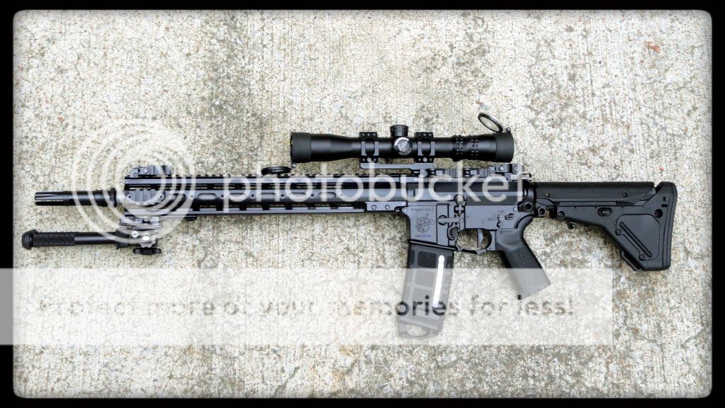

    We are looking to put a NF NXS 2.5-10 on my lady friends SPR build but we are having a tough time choosing a reticle. She has shot the NPR-2 reticle and liked it a lot. She has not got the chance to look through a mil dot reticle yet and neither have I. She is leaning towards the NPR-2
    To be perfectly honest I know nothing of how to use MIl/MOA correctly and neither does she so we are not set on one or the other, we are willing to learn. With that said which would you go with and why?
    We do intend to get matching mil/mil or moa/moa reticle/turrets whichever direction we go.
    From what I have read Mil sounds easier in theory because of the ability to simply use multiples of 10 when figuring things out, MOA sounds much more random.
    My buddy with the NPR-2 is sold on the velocity reticles out now but I dislike being stuck on one load of ammo. I personally end up with multiple types of ammunition and like the ability to shoot them all without guessing.
    What say the brain trust?

    Easily the single most impressive display I've seen from my LV in the 2.5-10x32 wasn't too long ago after prob. owning the optic for close to two years.
    I took a good friend of mine out recently who had just wanted to check out some LR shooting, and he had never fired even so much as a stock 6520 in the past, let alone a true blue LP AR at significant range.
    Right before we cruised for the day, I ask him if he wanted to try out a very user friendly AR for a few shots...he smiled big and so I grabbed the SPR which had yet to even be fired that day.
    I set him up prone, taught him how to send the bolt home, and lastly showed him how to make it safe.....that's it, 1min. of time. We were 635yds away from a 2/3rd torso sized steel target, and the LV/rifle were doped for Hornady SF 53gr. VMAX(IIrc 243yd sight in @ 200yd).
    I backed completely off of him, told him to hold ever so slightly off the very last hash in the ret (600yd hash)....and then hold 1ft. off the target to the left. Before I could even get down for a spot, I heard the magical BANG........DING!
    I called bullshit beginner's luck, and told him to send a half group or 4 more rounds. Ultimately he went 4/5 at 635yds, and registered a BANG..DING his very first trigger pull on any type of AR rifle.
