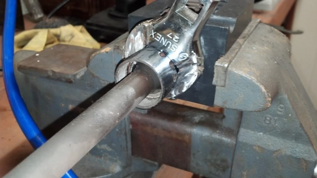

    1. I know if you search a bit you will find people who have hard a hard time as I did with getting the NSR to line up within proper torque regardless of making sure debris, excess grease etc. was not contributing to the problem. The 1st attached picture is of the Noveske 7.5 with Viltor upper, that I had torque issues with. Of course it is fixed now so the image is pointless.
    2. Same goes for having to grind a barrel nut tool NOT THE BARREL NUT. I have attached a photo, but that is not a big deal.
    3. BARREL NUT ---- I had to USE A LATHE on the barrel nut, on another build to take a few thousands of material from the inside of the barrel nut to clear the barrel shoulder (the part just before the barrel extension).
    Attachment 15035
    The barrel nut tool ground to fit.
    Attachment 15036
    I hope this was clear. My only point was to say that in some cases, the NSR takes a bit of work.

    That is what I'm looking for clarification on. How many barrel nut wrenches did you have to buy, and how many did you have to grind to fit?
    The 1-1/16" crows foot needed is not super common but easily found. Mine (as well as some others) were too fat to fit the NSR barrel nut. So to your point, I bought one and ground it down. I didn't factor it into the price of the rail, nor think it is a deal breaker. Image link below
    Jt

    The 1 1/16 or Sunex 27 mm works fine with a small bit of trimming. Got it off Amazon for just a few bucks. Took 20 minutes to get the correct width to fit the NSR barrel nut. No big deal whatsoever.
