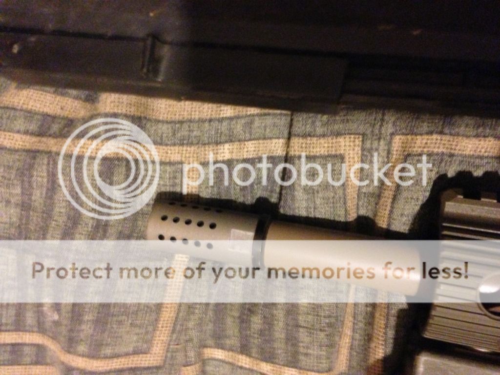

    My friends muzzle comp he makes

    If the comp doesn't completely clear the handguard, it's a waste. The gases need to vent free & clear of the rifle to be effective.

    The brake just clears the handguards and I know what you're saying about the gas length system, but the rifle will be tuned for it... He's dead on the money with the way he does the gas port and the tuning of the rifle. I've got $3100 total combined in both builds, so I'm doing ok in that department.... Especially with the way things are right now

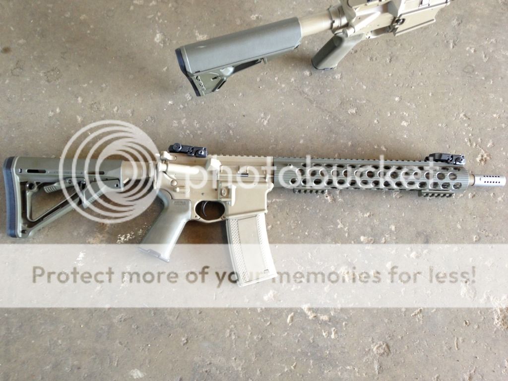

    Picked them up and they shoot like a dream..... Even the SPR with a CARBINE gas system. They have identical paint, the lighting was just different. Mounted the optics after the pic and punched holes in the same spot using the 75gr loads I have. Working up my 77gr loads now... The 2lbs Jard trigger on the SPR is awesome. I love it. The SBR breaks at 4lbs and its very smooth as well

    Looks like a 13" rail on that 14.5", not 15"
    Nice looking builds, I like the paint-jobs.
    The 18" carbine thing is odd though.
    EDIT: Not sure, but from the picture it might be a mid-length?

    Quote Originally Posted by saddlerocker View Post
    I was just about to post this. A 15" rail would cover the whole barrel and most of the comp.
