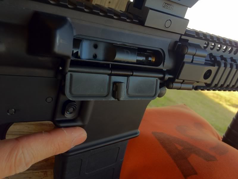

    greeneggsandham - It doesn't look like that. When the failures happen, the bolt is most of the way back and the bullet is kinda jammed right above where it would be in the magazine. It seems to be jammed right up against the silver angled ring which i'm assuming guides it into the chamber. I wish I would have taken a picture, but that's the best description I can give without one.

    UPDATE: So I finally had some time to go to the range today with both my DD and my Core 15. I used the same 3 magazines as earlier mentioned, the results are as follows:
    DD: Pmag- Fired all rounds
    Tapco - Jammed on first round
    Aluminum - Jammed on first round
    I took the two mags that jammed in the DD and put them straight in the Core 15:
    Core 15: Aluminum - 20 rounds just fine
    Tapco - 20 rounds, last one double feed
    Ive included picture of what the DD looked like with both the jammed magazines:
    This didn't really do much to convince me that everything is A ok with my DD...Sure it fired alright with the included PMAG, but I highly doubt that they make a weapon that can only fire with one type of magazine.
