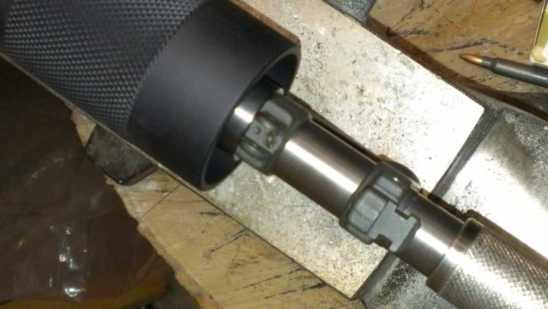

    That screw isn't enough to hold the block in place. I had this on my .223 pistol upper and it walked even with the dimple so I drilled the front strap of the block for a taper pin and had planned to install another in the rear when the front one had been set. Now I've sold that barrel and have switched to a 300blk and will be doing pins on it.
    The screw is simply too small to do anything effective. Someone had a "great idea" that didn't work in reality. A 3/16" roll pin is cheap insurance. I happen to have a tapered endmill that fits my taper pins, so I use those. If I didn't, I'd use a roll pin if it might be a mission critical gun.
    I'll be working on that upper in a bit, I can take pics of the FSB then.

    With the other spot in there (closer to the upper), it almost looks like they intended to have two screws at first.

    Yeah that would never work for the long haul. Better to send it to ADCO and have it pinned for $90, or as a distant second choice, replace that FSB with a clamp-on for $45.

    That's at ADCO, so he'd have to add the cost of shipping both ways. IMHO drilling and pinning it with taper pins would be the most secure way, but others have said that clamp-on FSBs are an acceptable alternative. Probably cheaper at a local gunsmith as long as that gunsmith has the proper jigs to get the FSB aligned perfectly. The clamp-on version would be pretty easy to install, but it would require that the muzzle device be removed. That's easy enough unless it's pinned and welded.

    I just taper drilled mine last night without anything but a bubble level and a vise. It's not rocket surgery.
