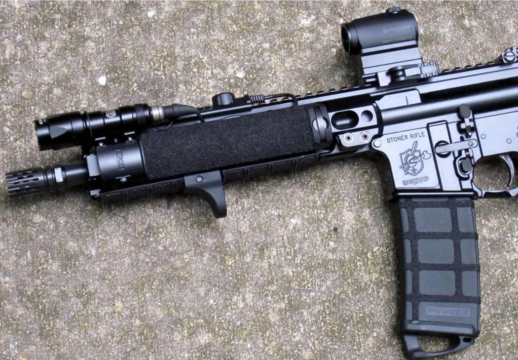

    I'm running a X300 in the 10/11 o clock position on my 10.5" SBR. It's compact and very easy to manipulate the toggles with my left thumb. Here's a pic of my setup. I'm using a Gear Sector mount.
