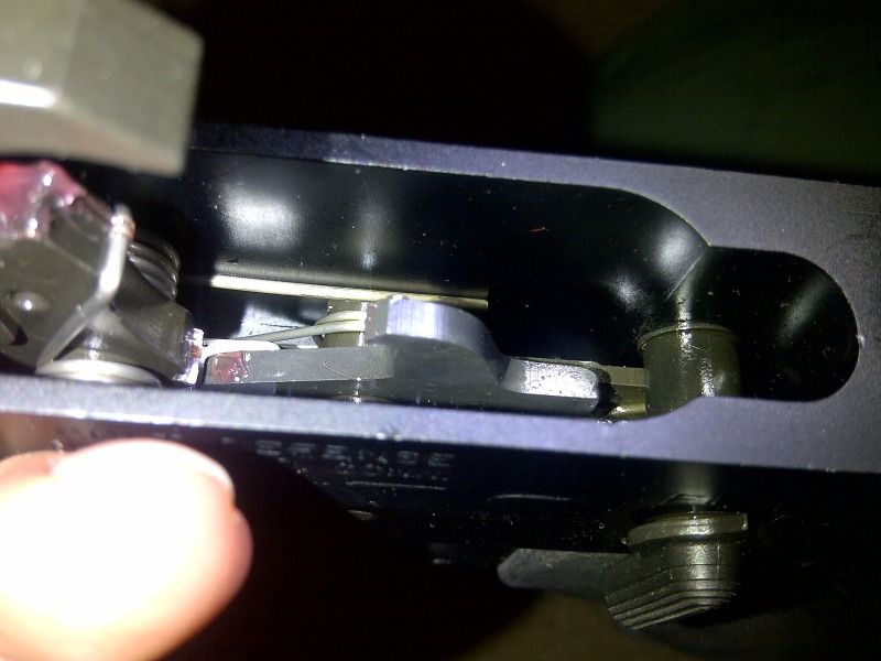

    Sorry. Home late now so no good light for photos. I'll see if I have better luck tomorrow.

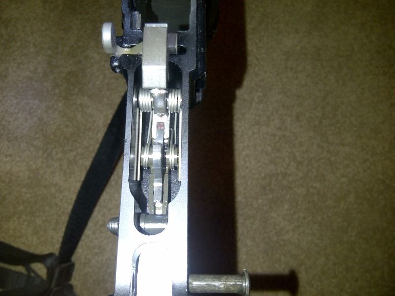

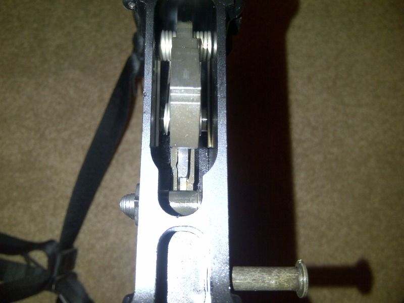

    Cell phone and a flashlight actually worked rather well. I'm surprised.
    Anyway, there doesn't appear to be anything different or unusual about the lower parts kit. I'm rather surprised by the notched hammer but I guess it doesn't do anything since the firing pin is shrouded.

    Pretty standard Colt lower...
