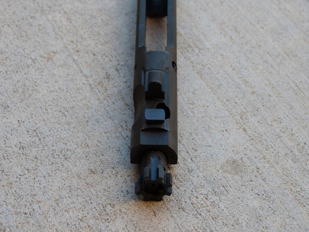

  10. #50
    Nov 2007
    New Mexico
    3,204
    As requested. Pics of the new bolt carrier strike face. The impact surface is flat unlike some other designs that use a concave impact point.
