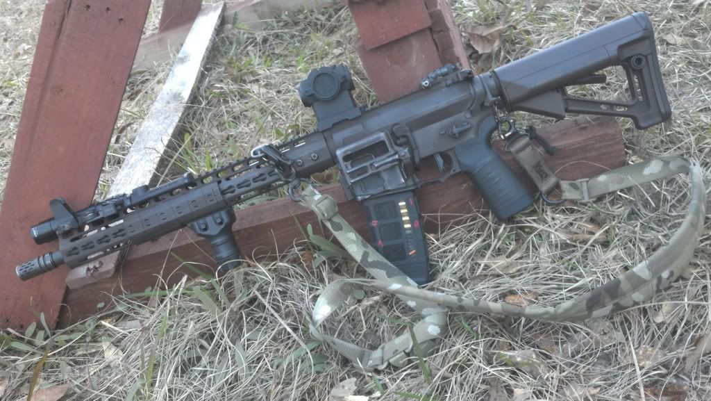

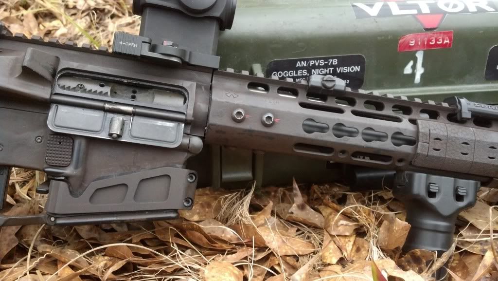

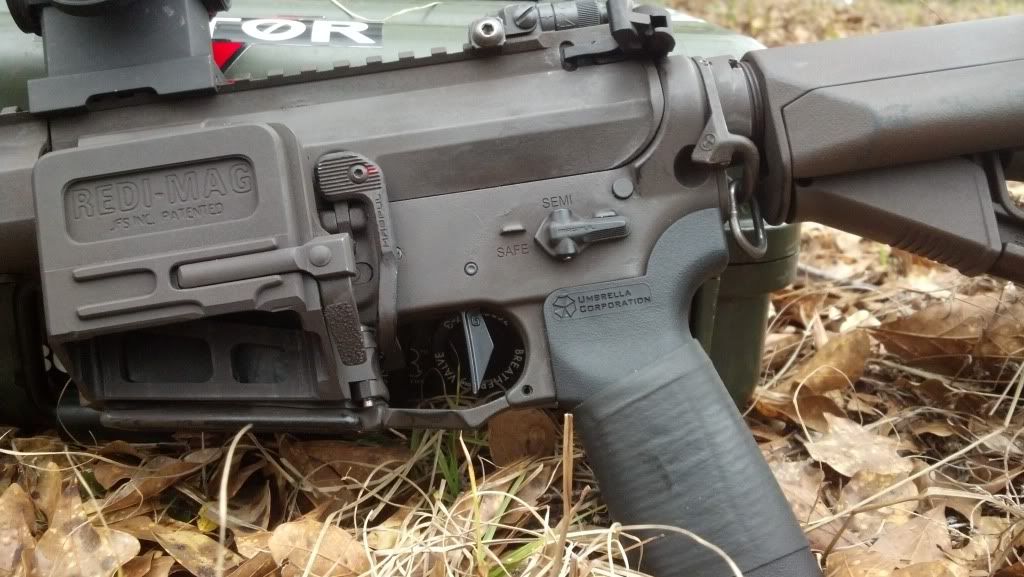

    Aluminum version:
    Redi-Mod:
    -Ryan Job

    Quote Originally Posted by 556noob View Post
    I'm curious to know what you see as downsides to couplers.
    Thanks.
    I haven't used one, but I've seen plenty of people post downsides.
    If you hit the mag release as you normally would with any other setup, you just dumped your next perfectly good magazine as well as the empty/bad one. You have to remember to grab the mag(s) before hitting the mag release.
    If the other magazine is open-topped, the top round can walk forward under recoil or as a result of your movement, and cause a malfunction when it doesn't feed properly.
    If the other magazine is open-topped, you can get debris or who-knows-what in the magazine.
    If the other magazine is not open-topped, you have to take an additional action...such as removing a PMAG's dust cover...before you can insert the mag, at which point simply going to your belt or chest rig or whatever for your mag is probably as fast/faster.
    And of course the extra weight.
    A redi mag or redi mod would seem to address/solve these issues. Hit the mag release and you only dump the mag that's in the gun, and the top of the mag is covered to prevent the top round from walking forward + protect it from debris.
    Although, as mentioned in this thread, people still see downsides to that...but it sure seems better than coupled mags, as long as you can live with having the thing on the side of your rifle even if/when you choose not to use it.
    Thanks.
    I tried a couple different versions out a few years ago so if I miss an important point out feel free to add.
    1. Magazine couplers are typically loaded with the right mag inserted into the magwell. When the left mag is inserted this leaves the right side mag sitting directly over the magazine release. Making it more difficult. to access the button if another mag is needed or if a malfunction that necessitates removing it from the magazine well.
    2. If you do need to remove a magazine to clear a malfunction (or even just perform a mag change) under stress you can insert the wrong one. I've done it myself.
    3. The possibility of rounds jumping the feedlips on the uninserted magazine. Companies such as Brownells make covers (and of course the PMAG dustcover) for them to keep this from happening but that is just something else to go wrong and slow you down.
    4. Two mags coupled together are more difficult to manipulate.
    5. Another malfunction related issue: If the uninserted mag is on the left side and you need to lock the bolt to the rear the left mag can make that manipulation slightly more difficult. For me at least es of course the same issues arises w/the Redi-Mag which is one reason I would never run one without a BAD lever.
    Most of the above can be chalked up to a raining makes perfect issue but in my humble opinion their are better more efficient alternatives.
    -Jax
