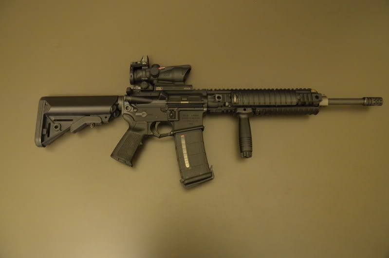

    I like the RMR on my ACOG. It's worked out well for me so far. No loss of zero. Cheek weld really isn't as bad as you would expect...

  10. #40
    Sep 2012
    9
    I have the ACOG/RMR on my AR that I mounted and sighted in on Saturday, with the RMR being so high and my cheek weild being low (ace fixed stock) I have to say it took a little bit to get used to where I had to be to find the dot. It wouldn't be near as bad mounted to the rail of course. The dot is super crisp and very bright even in the 90 degrees weather we had on Saturday with this west Texas sun. It was also almost zeroed at 50 yards, which is where the owners manuel says to zero, and stayed super crisp through some rapid fire.
