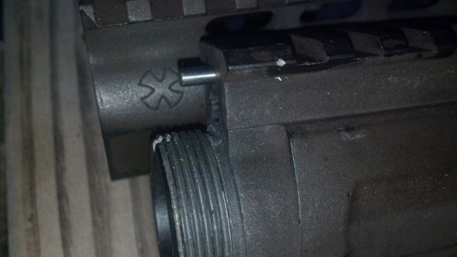

  6. #26
    Jan 2009
    Mississippi
    3,996
    50 (100%)
    The pin is slightly more than halfway into the MUR. As mentioned before this is a Vltor MUR so it was drilled post factory.
    The pin rests in the NSR at the halfway point.
    Fully seated in NSR:
    Fully seated in MUR:
    Apologies for the shoddy cell pics.
    Not sure if this helps any one but I said I'd post up photos. So there ya go.
    -Jax
    -Ryan Job
