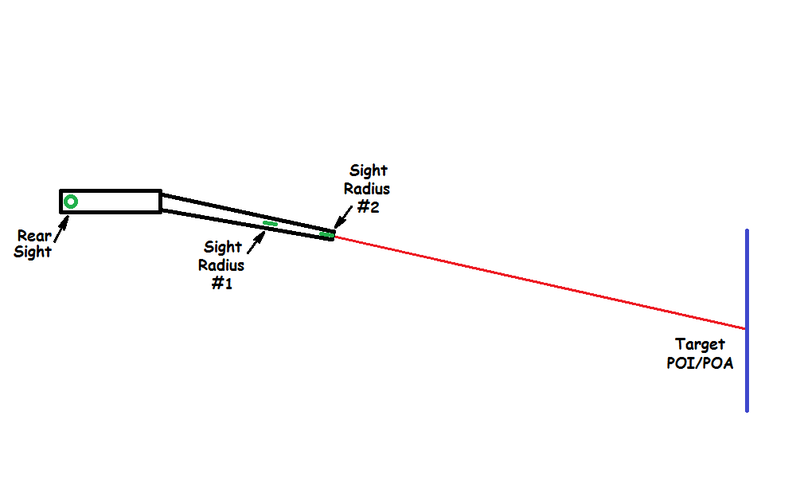

    Quote Originally Posted by bp7178 View Post
    Have you tested this or just come up with a hypothesis? Also, in your 0.004" example which results in 3 clicks of windage; what length sight radius, what is the distance the rifle was zeroed at, and what is the click value?
    It would be interesting for someone who had the resources, to take a upper and purposely make it out of square and test. Its a pretty common complaint whereas users will need what they consider an excessive amount of windage. I don't think I've ever read anything definitive about it, just a lot of internet bickering.
    Unless your upper receiver and barrel extension reside in a plane of existence where the rules of trigonometry do not apply, or two different objects can coexist in the same space, my calculations are pretty darn ‘definite’.
    And, you don’t need to purposely destroy an upper to show this is the case. With a barrel inserted in the upper all the way to seat on the flange, without a barrel nut, or the nut not engaged on the upper’s threads, gently try moving the muzzle from side to side. Try to keep from bending the barrel.
    Twelve (12) clicks of windage, with 32 pitch threads on the windage screw equals 1/3 inch.
    If the barrel is loose enough in the upper to allow the front sight to move more than 1/3 inch, then it is seriously out of dimensional tolerance. If it does not move that much, measure the extreme movement, I’ll bet it is at most a few thousandths of an inch.
    Oh, and about the sight radius - think about it. It doesn’t matter.
    If the barrel is pointed off to the side and it takes 15 clicks of left windage, or .417 inch, to correct it, how far to the right is the front sight?
    For illustrative purposes let’s look at this exaggerated example below. Print it out and draw where the rear sight has to be in order to zero this barrel with the front sight in position #1, now doing again for position #2 . . . Does the position of the rear sight move with a different front placement?
    Nope.
    (Note: we are looking down from above the rifle with an extreme mis-alignment.)
    Now, how much is the rear sight offset?
    It is the tangent of the angle between the center-line of the upper receiver and the barrel axis multiplied by the distance from the rear sight to the bend. And, the angle of the bend is the arc-tangent of the distance the front sight is offset divided by the distance from the bent to the front sight.
    Play with the math as much as you want, but the rear sight offset will always be less or equal to the front sight offset, except for pistol length barrels. And even with those, unless the distance from the extension flange to the front sight is less than three (3) inches, the rear sight offset will be the same to one or two thousandths of an inch.
    In my above posts, I used the worst (realistic) case where the rear sight offset was the same as the front sight offset.
