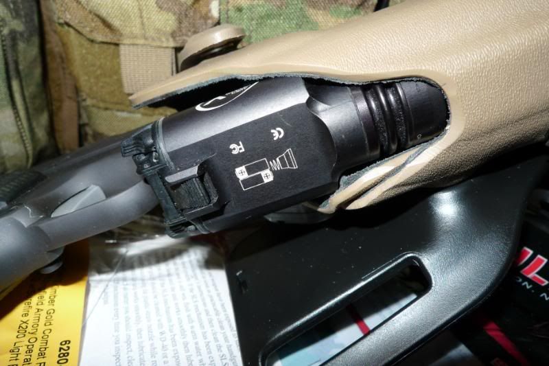

    this pistol is owned by a member here. I hope he doesn't mind me using his pics. He's using a colt with a caspian rail, surefire x200 and a DG18 switch (Kimber TLE with rails, SIG GSR 1911 with rails, Springfield 1911 TRP with rails)
    notice how much lower the switch sits under the handguard:
    and notice the same setup on a factory railed gun:
    and this is that same gun trying to get into a safariland 6280 for a railed 1911. that's as far as it would get into the holster

    Years ago I installed the Caspian Recon Rail on a Springfield Armory 1911. As the photos above depict, I had trouble finding a duty holster for this set up. I finally got it to work with a Sarfariland SLS for a Glock 21. I was never happy with the setup. I removed the rail and had the three holes welded in and the gun refinished.
    My personal recommendation is to buy a factory railed gun. Absent that get a rail that, when installed, has the same profile as the factory version of that gun and will fit in the same holsters.
