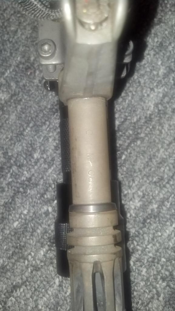

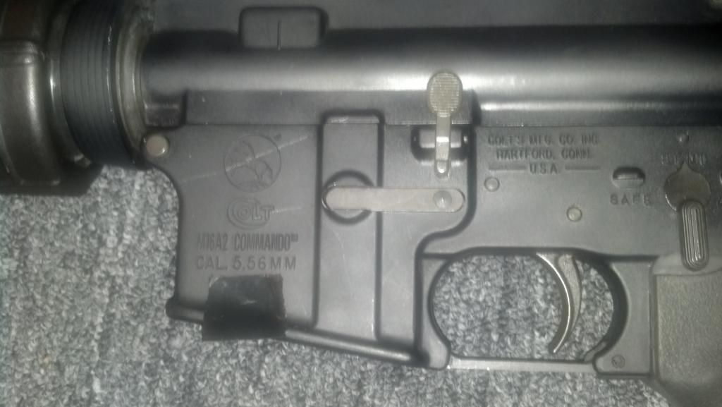

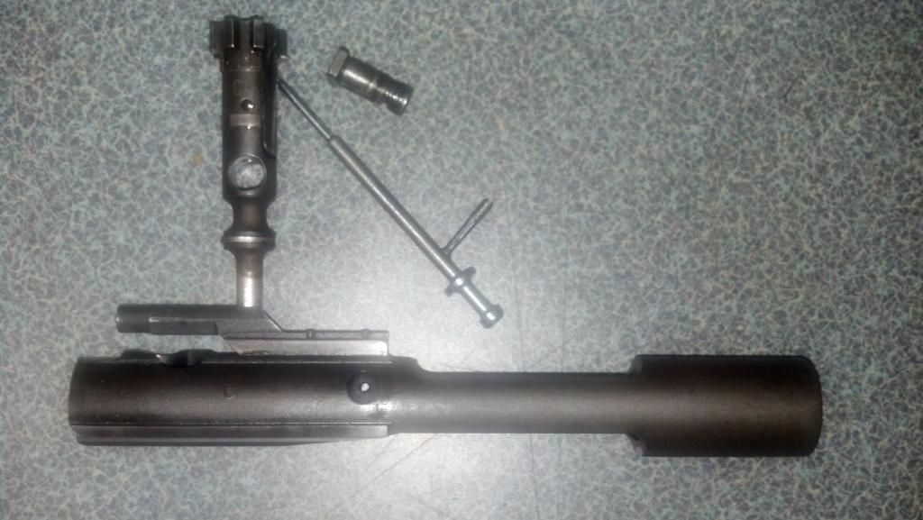

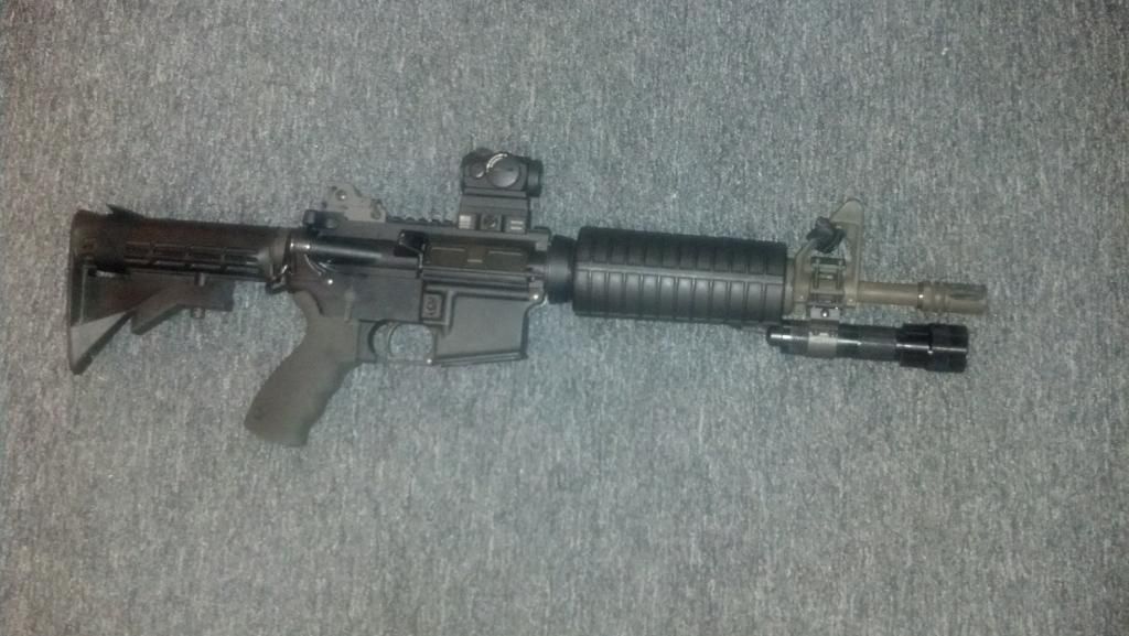

    Can you post a picture of this gun so we can see if it all Colt?
    "Not every thing on Earth requires an aftermarket upgrade." demigod/markm
    Oct 2010
    13
    Here's some pics. Thanks for looking.
    Oct 2010
    13
    Just to clarify the only non-Colt parts on this weapon are visable in the first two pics. Thanks
