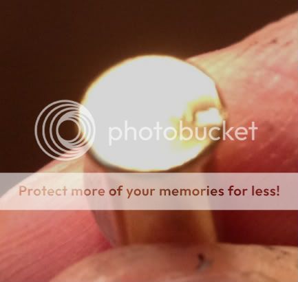

    this is a common issue with cmmg .22 bolt carrier group.
    if you have another .22 rifle/pistol compare the spent casings from each gun. i can almost PROMISE the firing pin impact from the cmmg will be at least 1/3 longer than any other gun you have.
    if that is the case take out the cmmg's firing pin and grind down 1/3 of the of it from where the center of the casing is outward (DO NOT GRIND THE OUTSIDE EDGE OF THE FIRING PIN)
    in short your light strikes will look like this
    (not my pictures, stolen from the interwebs)

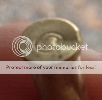

    you want to grind off enough of the firing pin for them to look like this
    i havent had a light strike since
