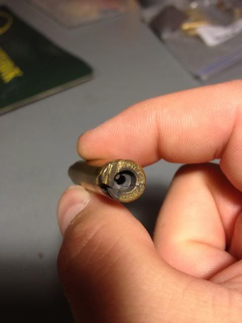

  7. #47
    Jan 2013
    86
    I am not sure if this view will provide any additional insight to the case/ammo issue or not, but here is another photo I took tonight of the case showing another crack in the base of the case - along the primer pocket/hole - that wasn't visible in my previous photos.
    Gonna take the carbine out and shoot it tomorrow night and will report back with results.
