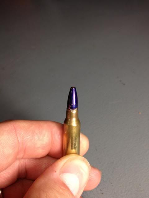

    Okay, I took the carbine out tonight for a test run.
    I fired a couple mags worth of 5.56mm Winchester 64gr JSP and Winchester 62gr OTM. Everything ran like a top, zero issues. I inspected each piece of brass and saw no signs of pressure or anything to give me pause.
    I do not have any candles in my home, but used a marker an tried a 5.56 round as suggested by Sinister above. Slight marks appeared on the round 0.11" north of the case mouth. Visually, it looks to match the above pictures 5.56 round.
    At the risk of sounding stupid, I have a fired .223 Rem case, but I am unsure which dimension from the above drawing I am to compare it to. My engineering and print reading skills could use a freshen up.
    Please let me know, I will report back!
    Thanks again!

    Where are the engraving marks compared to the orange line?
    Marks on the bullet of an unfired cartridge should start around 2.0026" with a 5.56 leade, 1.812" to 1.870" for SAAMI .223.

    I believe they fall above the orange line. It's the max diameter of the bullet before it starts to taper - on a Winchester 62gr OTM.

    I realize this is very subjective... I will try to upload a picture of it tonight.
  10. #60
    Jan 2013
    86
    This is the best I could get:
