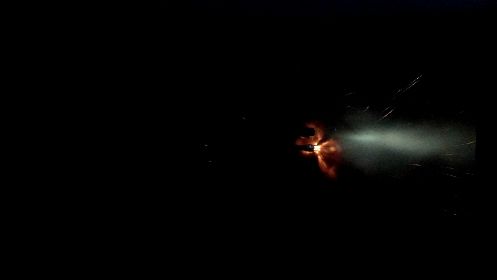

    It was a decent learning experience and I didn't know the muzzle could put out that kind of pressure. I was amazed when I saw it.
    I don't mind bringing a bone headed mistake to the internet, maybe I helped someone out today. My main concern right now is getting the 16" back up and running with a rail. My dept went through the drmo process and got a bunch of Vietnam era m16's for patrol use. I was using the 16" for duty to avoid the Vietnam weapons.
    Sent from my DROID RAZR using Tapatalk 2

    Still that gas is going somewhere, IMO if that's your AR your playing with stupid. I just would not chance it personally but I still have use for my right hand, I'm married
    Op thanks for posting, I am glad you are also ok. The Noveske Pig directs the pressure outward so if I did run a setup like that I would be using that MD, and even then it would have to be on an SBR and if it benefitted my team in a CQC situation, otherwise I do not see an advantage to that MD or setup (tucking the MD like that)

    This was a build I had been playing with when I bought an 11.5" bcm barrel during the panic. I pieced it together with parts laying around and was waiting on a good deal on a 9" or 11" rail. My duty rifle is a 16" bcm upper I bought without rails and was using this rail on it until yesterday.

    Curious as to what comp that is on the muzzle?

    Quote Originally Posted by Sticky View Post
    BCM
    Yeah this (pic of my BCM comp) hitting that Fortis may (obvuously did) do some damage:
    Nobody blow that statement out of proportion saying that I think it was just that comp that did it and if he'd used something else this wouldn't have happened.
    -Jax
