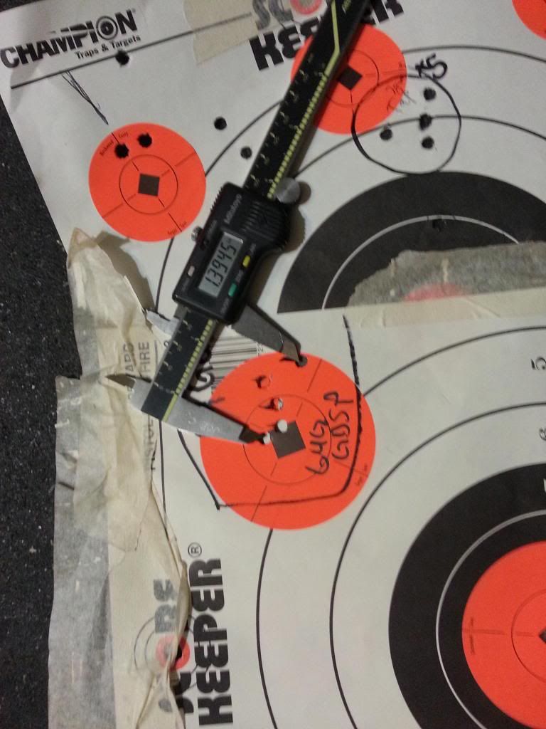

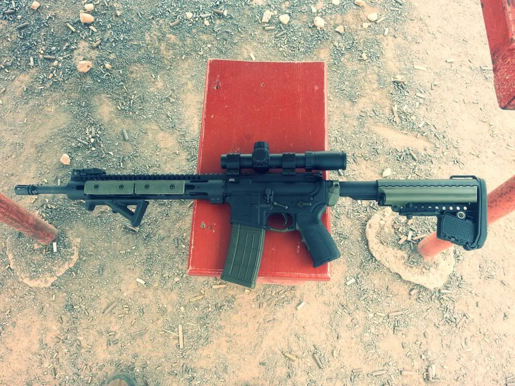

    Range results were not as great as I hoped. After I zeroed the scope ( 1x5 Weaver tactical) at 50 yards I proceeded to print a 9 round group that was .980 so I had high hopes that I would be able to print a 5 round group at 100 yards...
    My hopes were not completely fulfilled. From a seated position and shooting off a bag ( not the best set up, but the best I could do atm)
    So with a 7-8 lb trigger this is what I got.
    Winchester XM193 @ 100 yards the best I could get was 2.304 group of 5.
    Remington ranger 64 SP best 5 was 1.843.
    Speer 64g GDSP came with a best 5 shot of 1.394
    Golden bear 62 g SP best 5 was 2.169
    Hornady TAP 75g BTHP was the best at 5 shot with .931 spread. I think this is 5... may be four.
    So far this all I have to test. I am going try some 55g ZMAX that a friend says runs sub MOA in his PSA barrel. I am going to try a fully supported set up along with a quality aftermarket trigger, I think that the groups will tighten up considerably... Still this is good performance for a $670 rifle ($1059 sale price - $400 Aimpoint that now rides an AUG)with off-the-shelf ammo

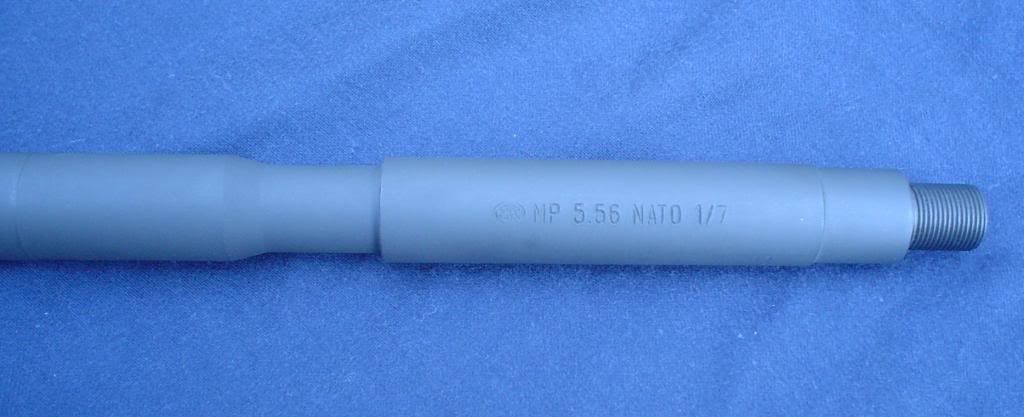

    That is because FN doesn't make any commercially available AR's or AR barrels (with their name on it).
    C4
    You just never know what may pop up.....
    found this for sale on TOS: 16" FN marked M-4 BBL.
    http://www.ar15.com/forums/t_7_22/11..._Stripped.html

    Looks like excellent performance in my opinion so not sure why you were disappointed. Most of the ammo you shot was 2-3moa ammo on a good day so no surprises you were getting 2" groups.

    Pulled very early PSA barrel. In order for FNH to make a barrel for the commercial market a makers must submit the design including gas port.
    They cannot make their own barrels to sale to civilians since Colt owns the TDP.
    That is why gas port could be anything, the manuf. tells FNH what they want.
