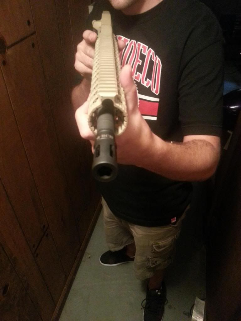

    Oct 2012
    269
    This is another guy, from TOS, who just put a Troy ALPHA on his BCM blem upper...my VTAC ALPHA was off exactly like this:
  8. #18
    7,984
    15 (100%)
    The problem there is mounting BUIS on the rig. You may or may not be able to adjust windage enough to even get it on paper. I had the same issue with a TRX Extreme on an unnamed upper. I was able to true that setup through judicious sanding of the interface and bridging the upper & forend top rail while torquing everything down.
    And yes it was a pain in the ass.
