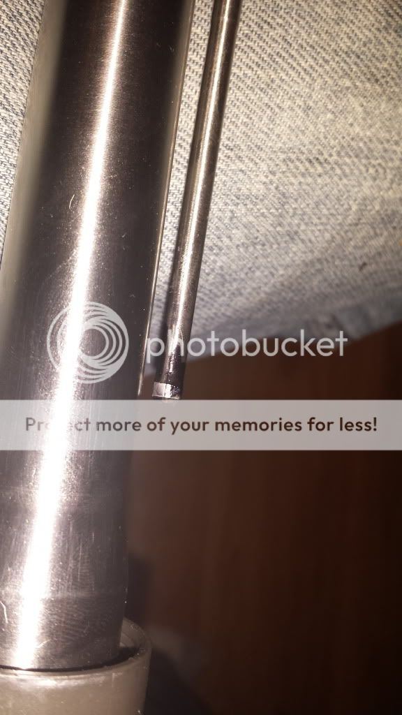

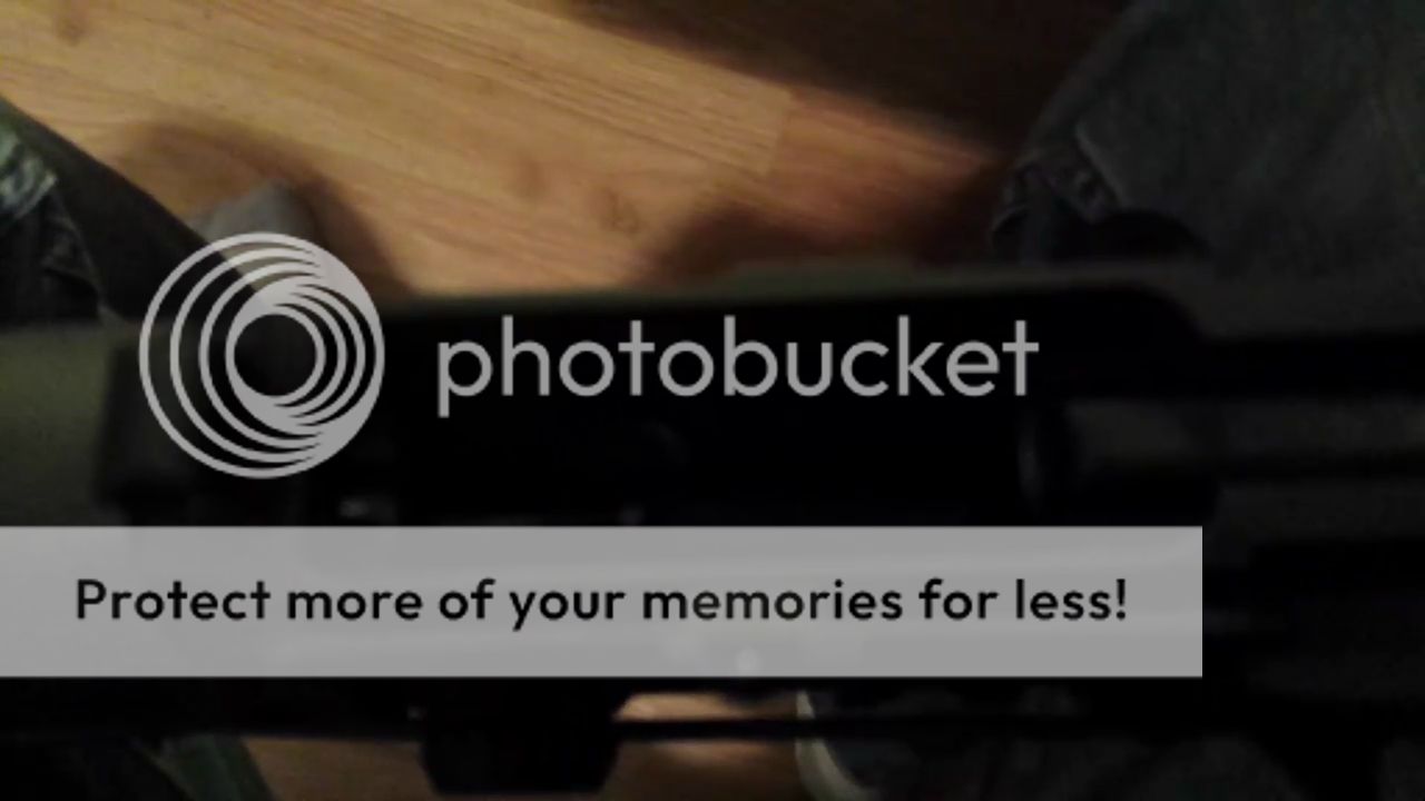

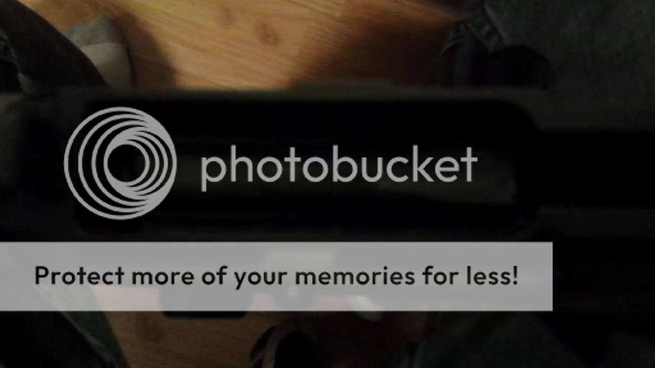

    So I pulled the gas block to put Sharpie all around it and check the alignment. Here are the results, using a stripped carrier, like IG suggested:
    Top
    Left side
    Right side
    Moving it back and forth, I did notice that it is a bit smoother when it's just the carrier. I can feel when the carrier key come into contact with the gas tube, although it's so faint that I can't imagine it would be what's stopping the carrier when pushed forward by the buffer. I recorded 2 videos, with and without the bolt installed, but I don't know if they'll be at all useful. They're uploading now.
    After re-installing it, I did my cycle-test again. It made it further before locking up, this time it seized up on round #14.
