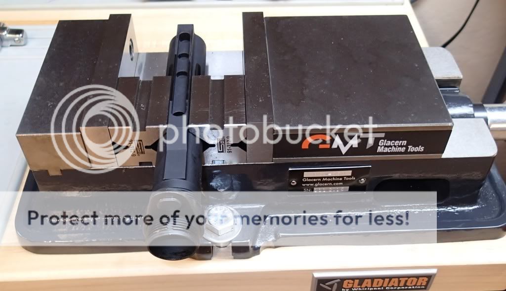

    My only (and minor) objection would on the one holding the tube. I try to "choke up" in situations like that, and clamp the tube as close as I can to the nut, leaving only clearance for the wrench.
    The clamping force on the extension is very light. The stock indexing rib on the bottom of the extension prevents it from turning. The clamping location relative to the vise location on the bench gives me 360 degree access to the receiver extension nut.

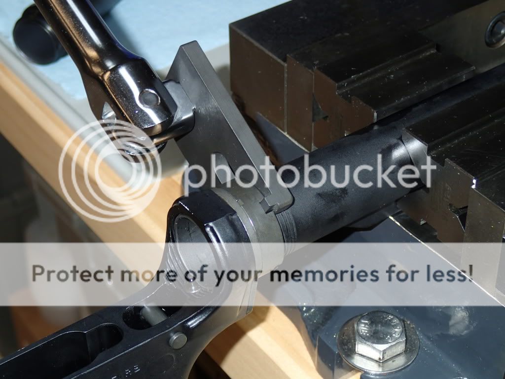

    I've had good results using the HammerHead tool, which engages all four slots of the receiver extension nut.

    Nice machine vise you got there MK18.
    Thanks! It's the only way to fly...

    I've seen a great many machine vises over the years though I can't remember ever seeing one used as a dedicated bench vise. Looks like a good one too.

    Quote Originally Posted by MK18Pilot View Post
    I Agree! They are great for holding all kinds of parts. I use one as a universal sight tool for semi auto slides and as a barrel vise for revolvers as well.

    All of these responses and almost none of them pertain to the OP's actual situation. Please refrain from posting if you do not have current 1st hand knowledge of what KAC is using on their current production SR-15s. The Brownells' wrench I posted is the tool KAC uses, confirmed by Jack, and is the best tool to remove the circular, dimpled style RE nuts. I will say good job on posting vise setups, this is just as important as using the right wrench.
