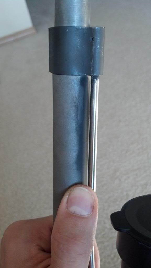

    Here is the pic of my gas block. Quality is not that great, it was taken with my phone. my thumb marks were the bulk of the carbon stops.

    While using calipers to measure a gas port is not that accurate, 0.080 - 0.085 would be on the big side... use a pin gauge or drill bit even to measure.
    You are getting a lot of leakage at the gas tube... my opinion. The FSB/Gasblock has some of the tightest tolerances of any parts on the M16/M4 - there should be no leakage at the tube.
    Also, your gas block *could* be off a little... I see it is pushed back to the step in the barrel - when I draw up a barrel, the gas port is placed 0.295 forward of the step in the barrel, if the barrel has a long "perch" for a full size FSB. This allows for the handguard end cap to fit behind the gas block.
    If I use a short perch (just over an inch) I usually spec the port at 0.265 and allow no room for the handguard cap that is not going to be used anyway...
    Most of the time, there are enough over tolerances to allow for you to push the gas block all of the way back on a "295 ported" barrel, but you are really better off spacing the gas block forward 0.030 - you will notice that most barrels that have a set screw divot opposite of the gas port will have a gap between the gas block and the step on the barrel.

    One of the first things I checked when I was having issues on the second range trip was to see if the lack of a gap between the gas block and shoulder was closing off part of the port.
    It was not. In fact the burnt carbon ring was dead center over the port and the dimple for the set screw lines up just right.
    When I assembled this rifle I noticed that the gas tube sort of just slid right in with little resistance. I had DD gas block before and the gas tube was noticeably tighter.
    Is there any way I could get this to seal without permanently attaching gas block and tube?

    If the set screw dimple lines up you are golden... some barrels are designed for the gap, some not - same goes for gas blocks; just something I noticed.
    Of course loctite will seal the gas tube, but is semi-permanent.
    For a quick fix, just to see if it helps, you can set the gas block "face down" in a press or on a mill table... so the hole for the gas tube is facing up... put a 1/4" or so ball bearing in the hole (like a golfball on a tee) and press it down like you are trying to force it in the hole... this will swage some metal down into the hole and make the very first part of the hole tighter... but not a permanent solution.
    You can tap the ball with a hammer if you can not press it... harder to control the "depth" of the press of course... but this method is far more amusing to watch. Best bet is to make the hole too small and open it a little with a 0.180 reamer or a #15 drill bit if you don't have the reamer.
    All in all... way more work than just replacing the gas block, but it is a quick way to see if that is your problem.

    Is that gas block home made? I have never seen one like that. There does appear to be some leakage and I think I would get a BCM or Vltor block and swap it out.

    K.L. -I will try to tighten up the fit between the gas bock and gas tube using the way you described.
    As a second idea could I use locktite RC if I cant get it to seal up correctly using the ball bearing? The only problem I see it that when it's in there it may be a little difficult to remove.
    IG- Haha no it is not home made, it's a just a basic Stag gas block.
