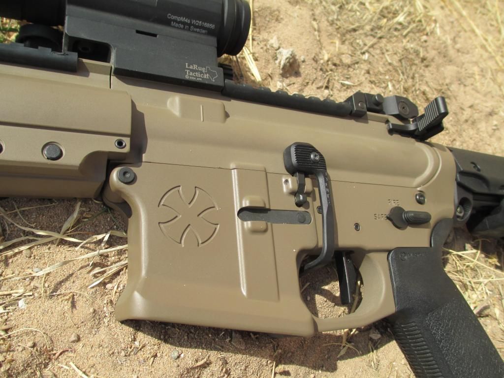

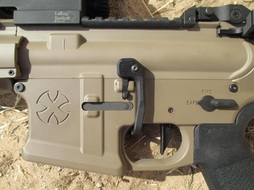

    This is probably the best example you're going to get regarding your question. My rifle is cerakoted in Magpul FDE, however the complete upper and lower were cerakoted by two different companies.
    [IMG][/IMG]
    [IMG][/IMG]
    If you look closely you'll notice that there is a slight variation in the color between the upper and lower although they are the same color. Obviously the mixing ratios were slightly different between the two companies giving the lower a slight shine to it.
    All in all you can notice it in certain light conditions if you look closely, is it a big deal? No, not really. Here is one final picture of my rifle, due to the angle and sun the difference in color is hardly noticeable.
