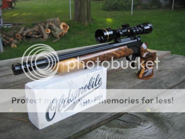

    you're going to look at me like i'm from mars or something, but it sounds like you want a contender/encore style pistol, which lots of people get in rifle calibers, put bipods on, and shoot at long range.
    https://www.google.com/search?q=cont...w=1600&bih=703
    it ain't 'tactical', but you can certainly hit steel and hunt with it

    Quote Originally Posted by taliv View Post
    Like these? In all fairness, the top one is a 460 and isn't a long range pistol but the bottom one is. I had that chambered in 7mm-08 Ackley Improved and is my long range hunting pistol of choice.
