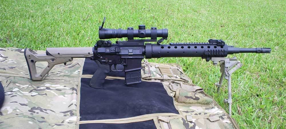

    I recently came home on leave to attend Paul Howe’s (CSAT) Urban Marksman (sniper) course and needed a rifle. I decided to put together something like an SPR for this event. I was the only non LEO at the course, which was closed to civilians.
    18 inch , 1/8 twist Lilja/Compass Point SPR barrel with Ion Bond coating.
    Larue gas block
    Vltor Mur upper
    Precision Reflex Long carbon forend
    Bobro Bipod
    LMT lower with Geissele two stage trigger
    Stock was a freebie from Magpul.
    Nightforce 2.5 – 10x
    I was shooting Prvi 75 grain match ammo that performed quiet well.
    The Nightforce scope was excellent. Only problem was that the center dot is 1.5 MOA and we were zeroing in on a 1 MOA black square. My tightest groups were just under .75 MOA but I suspect it shoots better than I can run it. I had no problems making quick hits out to 500 with this scope, and it was very fast at hitting movers at 100.
    The bobro bipod worked great, and drew a lot of attention from the other students.

    Nice set up. Nice stock at a great price . The Nightforce 2.5-10X is quite popular and a good value. Enjoy your new blaster.
    How about a few words about the course, or an AAR?

    very nice. if I may ask, where did you get the barrel? MSTN.biz?

    I will work up an AAR for the course.
    The barrel is from MSTN. It came with a "matching" bolt, but I used a bolt carrier group from Bravo Company, that Denny's gun had coated with Ion Bond. Not sure how they match bolts, but this one seems to be working well.
    The Magpul stock worked like a charm. I have another one on my M4 back in the sandbox that I have been running for the last 3 months with no issues. I have also been using PMags over there for the past year and they have been great.

    Did you paint the Bobro bipod or did it come in that color? BTW one hell of a shooter you got there?

    Very nice. How was the weight during the class? Does the bi pod weight more or less than a Harris?

    Shihan,
    I painted it with Rust-Oleum camouflage Tan, since I will be using it back in Iraq.
    Doc,
    Not sure what the weight is, but it is very comfortable and well balanced. The handguards were well worth the money. Much better than the chunky rail systems I tend to dislike.
    AAR is now posted in the training section...

    I guess you could call this my 2nd build. I brought the scope and bipod back with me to Iraq. Magpul donated the stock and mags. The upper was purchased already built, but there are little details about it other than the PRI forearm. Not sure what the twist rate is, but it shoots the issued Mk 262 Mod 1 well, a bit under 1 MOA.
    The lower is a standard Colt M4. Only thing that needs work is the trigger.
    I did the paint job, but could not paint the lower since it is an issued weapon.
