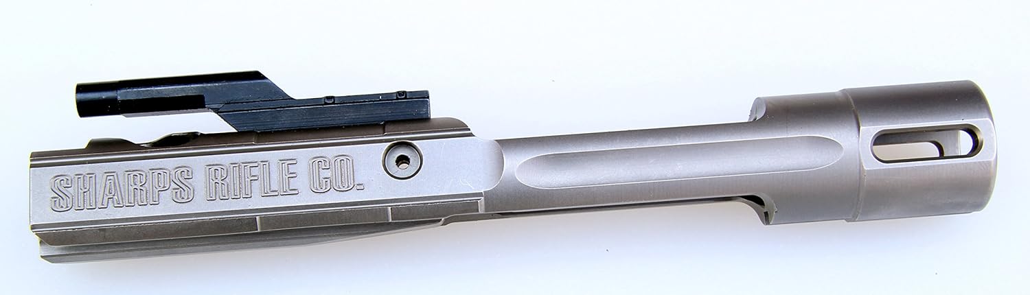

    I see a lot of similarity in the Sharps carrier and Azimuth carrier.

    interesting, the azimuth carrier is 8620 and supposed to be heavier than a typical FA variant. ranger proof sells them, but they want the same price as src and it's not s7. too bad the src carrier was lightened, i am a bit skeptical of the flat sides, but am no engineer.

    Anyways I do have a few issues with what was said in that video. First of all rotational caming is limited by the carrier key and upper receiver. It is generally minimal and I have never seen any corrolation to issues as far as that goes. Secondly this is not an op rod driven rifle, there is no tilting of the carrier from the gases interaction with the gas key, as the gas key only funnels gas into the expansion chamber. There is no movement of the carrier while gas is funneling through the gas key, and the carrier only begins to move once gas has filled and begun expanding in the chamber. Also the flats on the carrier are a cost cutting measure, simple as that.
    Now it does have some benifits that could prove to be advantageous. The enlarged rails, sand cuts, the enlarged rear offers a better more solid fit into the upper. These could be an advantage that only time will show. But the video was just dumb.
