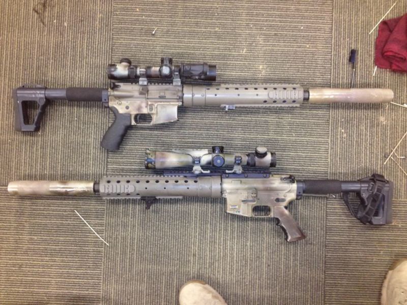

    I do not know if I will get in trouble for necrobumping, but I would like to add my own "Handy Rifle" to the thread.
    18" rifle gas Nordic components barrel
    Vltor A5H2
    Geissele SD-E
    After chatting with Buford via PM I plan on changing the stock out for a BCM and getting some lighter weight small parts to get to closer to 8lbs, I also changing the race brake to an EFAB.

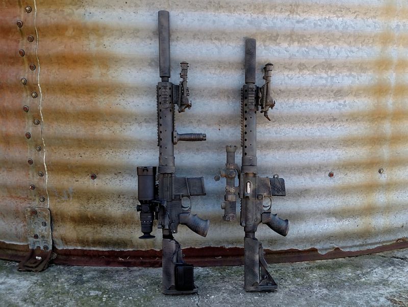

    My SPR build is similar in concept, my fav to shoot by far.
    I have a Rainier evo on the house gun.
    Pretty decent rail.

    Updated weight and components for the handy rifle:
    6.86 lbs with no mag
    Rainier Arms enhanced trigger guard
    V7 ambi Ti core selector lever
    V7 Ti take down pins
    V7 aluminum end plate and castle nut
    V7 mag catch
    Phase 5 EBR V2
    Magpul K2
    BCM KAG
    BCM gunfighter stock
    Vltor A5H0 buffer
    Precision Armament EFAB
    There aren't many 16" middies that weigh what mine weighs. None shoot as smoothly.
    I could save more weight if Iraq Gunz decided to make a lightweight melonited 18" barrel with rifle gas and .625" gas block journal.......or BCM an ELW version of same. That would easily save another 2 to 4 ounces between the barrel and commensurately lighter gas block.
